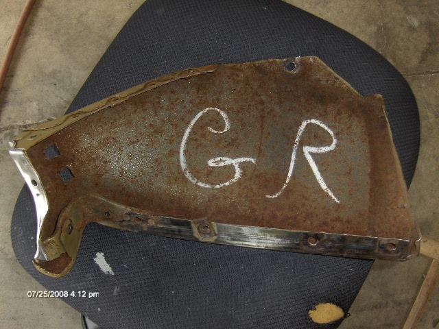

These are
on my Z. Friend says these are swap meet parts!
Bill
