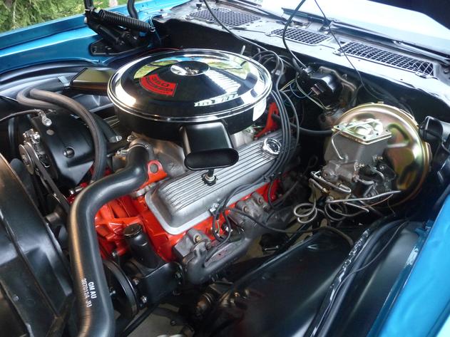

Here's what I'm working with. You can see the rust
beginning.
DH [img]<<GRAEMLIN_URL>>/flag.gif[/img]
