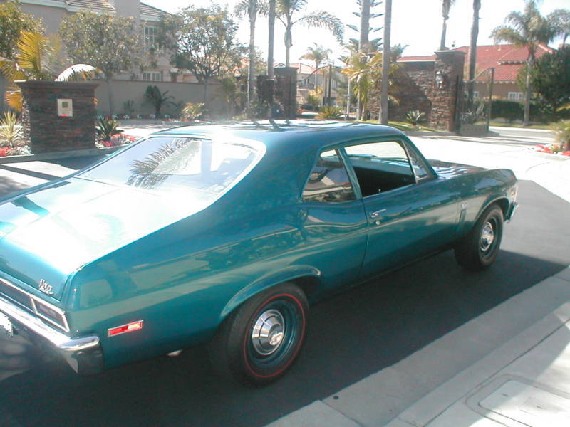

I had a Flow master crossover muffler on a 1970 L78 Nova with the tips that ended at the quarter panels. I really liked the sound but I did not like the way the 2.5&quot; pipes came out straight out of muffler then bent back to the back of the car. It limited the amount of wheel and tire back spacing I could put in the rear fenders.
