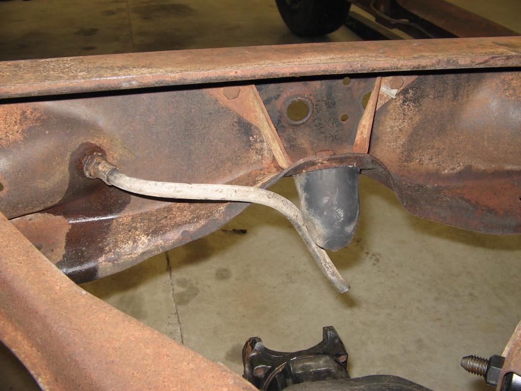

Just a few more until I find the treasure trove of random pics that look like they were taken with a potato.
/Users/iancote/Desktop/MVI_0921.AVI
1970 L78 Nova Best ET 9.14@152 MPH Street trim
1970 L34 Chevelle Matching #s Project
1970 LS6 Chevelle Matching #s Project
2001 LS1 Camaro SS SOM Stock
2008 LS3 Sierra Denali Blk Stock
Old 03-07-2013, 01:19 PM
Posts: 10,327
Thanks: 3,166
Thanked 4,585 Times in 1,140 Posts
Default Re: My 70 LS-6 project
Great pictures Ian. I have found most plants dip the pinion bumper brace in black paint whereas the Leeds cars always seem to be natural steel just like what yours appears to have been. What is that under the bolt head on the right side? Almost looks like remnents of a metal tag.
