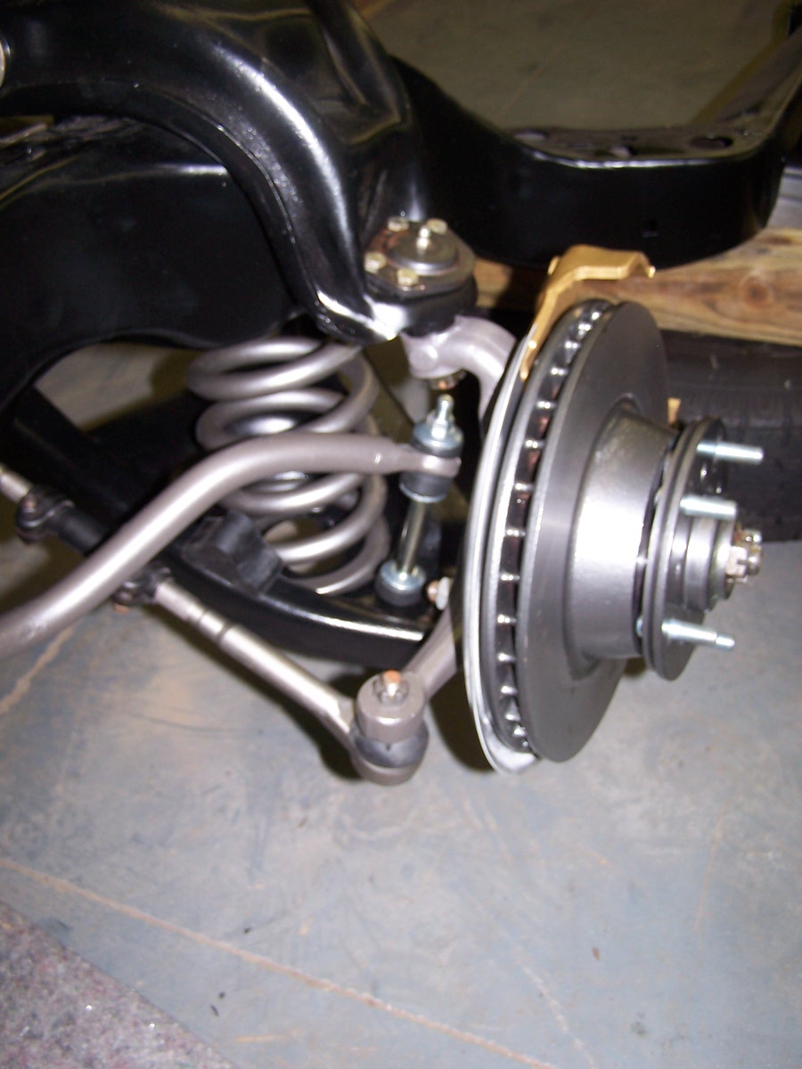

I have read several ideas on people using fluid film, boeshield, rem oil or cat blast paint. I used a product called rpm on my coil springs. Anyone have something they really liked that they didn't have to reapply? Car won't be driven alot but i don't want rust. Not sure how some of the products will tolerate brake heat on rotors and calipers either

I powdercoated my 2-piece rotors and calipers. Calipers got black and rotors cast blast in color. After the 2-piece rotors were re-assembled, I had the local napa turn them to get the powdercoating off the brake surface.

When I did the front suspension on the Chevelle a few winters back I decided to go a similar way as Jim (wheelhop). This is not a trailered show car, it is driven regularly in the summer and once in a great while I get caught in the rain.
I had the cast stuff powder coated to appear cast (guy up in Delavan, WI). I really like the results of Rick's (SS427) process but not sure how it would hold up being driven regularly or even if it got soaked in the rain.
This worked for my non concourse application and is holding up very well even after 3 or 4 thousand miles and being caught in a few rain storms. Much better than "cast blast" in my opinion as it has a more "as cast" dull/course finish and much more durable.
