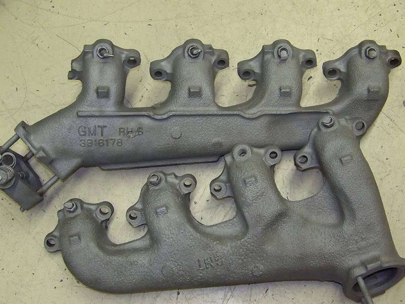

John Brown's Avatar
Location: South Bend, Indiana
Posts: 2,820
Thanks: 455
Thanked 510 Times in 243 Posts
Default Re: Question on '65 L78 vs. later L78s
Here's what 396/427 Chevelle/Camaro ex manifolds look like.
John Brown
