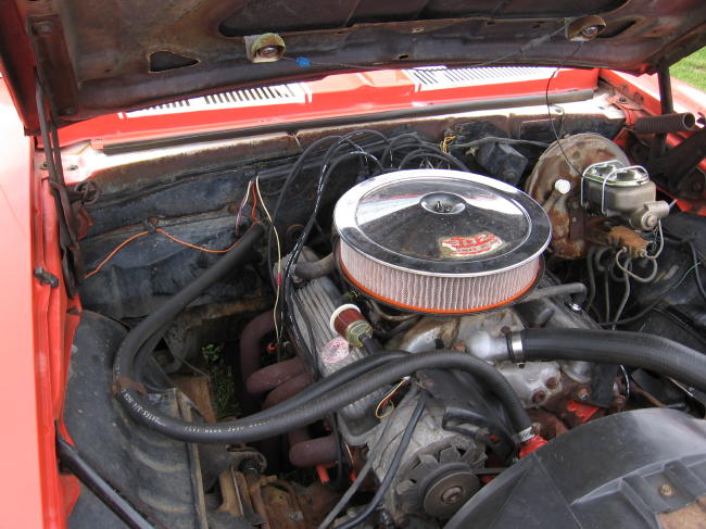

this is a pic of a real LA 67Z,the pic shows the line where the white was ended by the factory on top of the cowl area

I gotta start doing my boosters that way....

isnt that groovy charley!! all it needs is some fuzzy feet LOL

Glad to see that picture of the 67 LOS Z28 cowl paint. That is how my LOS 68 Z was before restoration. Problem is every time I say that is the way mine was I seem to be corrected by people that never seen the area before restoration.

that is the original paint under the black paint that was applied by one of the owners.you can see where the red paint is also under the black paint.the other side is the same.I would guess they used some sort of stencile just to lay over the edge and did a qiuck white spray paint on the top.This is a white stripe car also with bolero red paint RR code.
