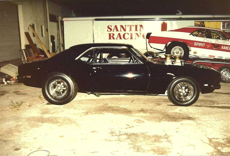

<font color="blue">I used to do a half pump thru the line lock just before the pre stage, ease the clutch into pre-stage, then stage ...
at the light blink, right foot to the floor, side step the clutch (approx 8K) &amp; hold the f**k on!
Looked at the Moroso tell-tale when I was done.
Not the most consistent, but definatly a lot of fun.
331cu.in. - Super T-10 long 4200lb clutch - Verti-gate - 5.57 dana - 13/31 slicks
