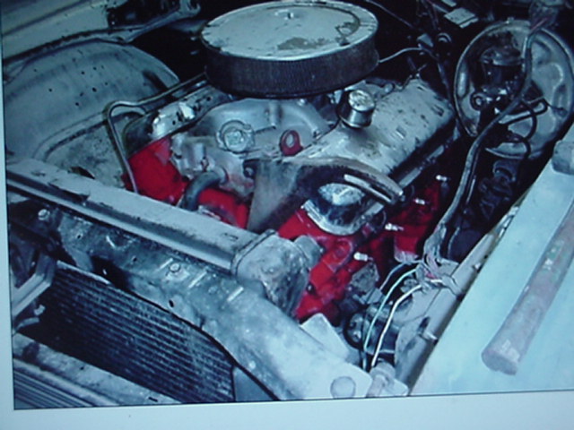

Would a 68 L78 have drippers on the valve covers? I need a set for my 68 L78 motor I am building. I know original ones are impossible to find in decent shape. So I want to make sure I order the correct set.Does any one recommend an after market pair they bought?

Any chance either of these 2 sets are what you are looking for?
If not, any idea what they go to?

Jason, the left side (single hole one) in the first pic is definitely correct for 69 Camaro, and I think Nova. (definitely not Chevelle) The telling things are the little bump-out on the inside rear, the inside spark wire tower being forward of the rear bolt hole, and the temp sending unit clip on the outside lip forward of the third bolt hole.
I'm not certain on what to look for for right side ones.
