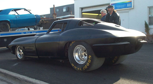

Well different for me, a mechanical Kinsler fuel injection unit with stacks and a fresh roller 510 ci 13-1 comp of big block chevy fun.( wow ) Have you ever seen these things light up ? pretty scary untill all the air is bled out of the lines and 130 psi of fuel is injected in the tubes it makes for a pulsating, poping, and flame throwing show. But when it finally does run it runs real nice and with 3000 cfm it makes some high top end power. It idles and it starts and we just ran in to seat the rings.
4" open pipes and VP race fuel make for a great mixture.
