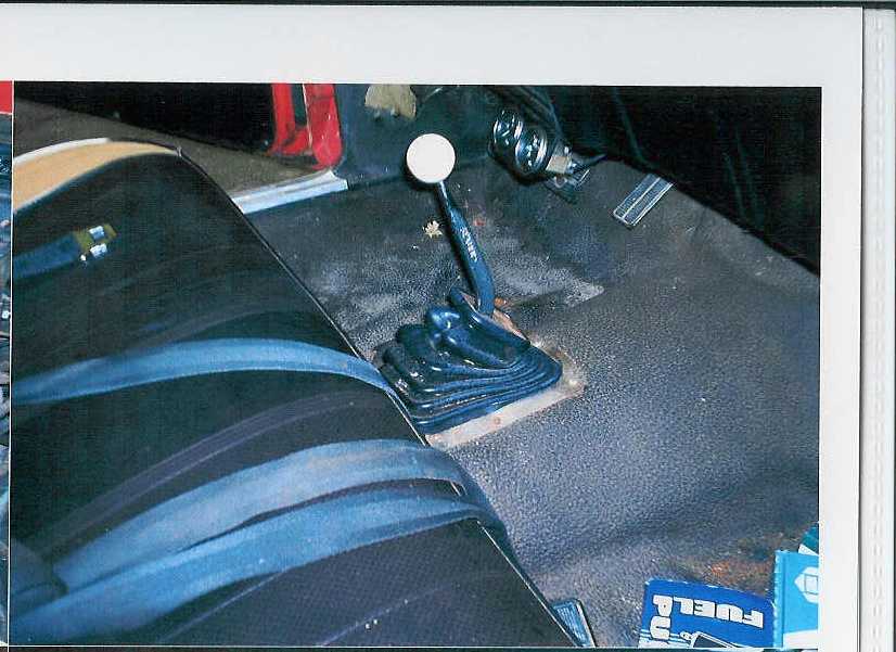

I'm going to be posting Yenko Deuce detail pics in this thread. This will help me catch up on my backlog of Deuce books that I need to send out. The resto section of the book will now be a simple reference to this thread.
Here is the first detail pic, the infamous GTO/Tempest bench seat Hurst shifter arm that was attached to the '69 Camaro Z28 shifter with small block attaching bracket and big block shifter rods. The '69 Camaro boot/bezel combination was also utilized. The additional boot/bezel that is commonly found will be in another pic.
Hurst arm #4177.
