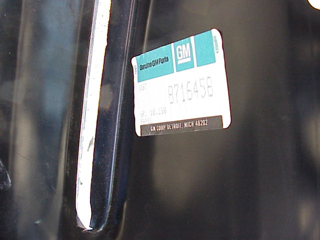

Hi to all. We are finally getting back into the L89 Camaro. And has just arrived from being media blasted, During the blasting process all of the firewall codes began to show through. I am used to seeing a few codes but this thing looks like a middle school chalkboard. We want this to be a 100% accurate restoration, I will give you a short picture tour of the progress, First off the car has a great history and has alot of original pictures of it through the 70's, Sold new at Humphry Chevrolet in Wisconsin. It is a RS/SS with 4.10,s and a M21 trans, Code 55 Azure Turquise with 712 black interior, Endura, Spoilers, console w/ gauges, Blue light stereo, vinyl top, Chambered exhaust ( built 10D 1968), Much paperwork and original owner still lives at same address as when he bought new!! We thought this was one of the earliest built L89's but I have seen on this board a Convertible that was built the week prior, This is a early Norwood car and has the smaller cowl tag, Car still retains all of it's original dated components and is 100% numbers matching, Car also came with the XT wheels and dog dishes which i think is awesome, OK, The firewall before any restoration started showed the typical B T P inspection marks on each side and a large T U R partially covered by the heater box, Picture shows letters traced to show up better. I have original pic's this is just for reference
