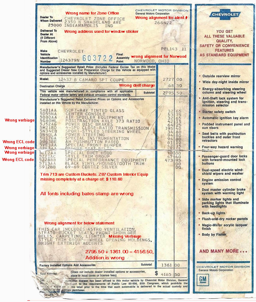

There has been many threads and comments regarding this 1969 Camaro VIN: 124379N603722. There have been plenty of posts on Team Camaro and CRG also commenting on plenty of issues with this car. The MacNeish report authenticating the car also has plenty of comments regarding this same car. Fake window sticker and POP. Engine block decked and re-stamped, replacement 4-spd trans re-stamped and casting number removed, etc, etc. Here's and analysis of the window sticker as information. Much more to reproducing a window sticker correctly than just aging it......
