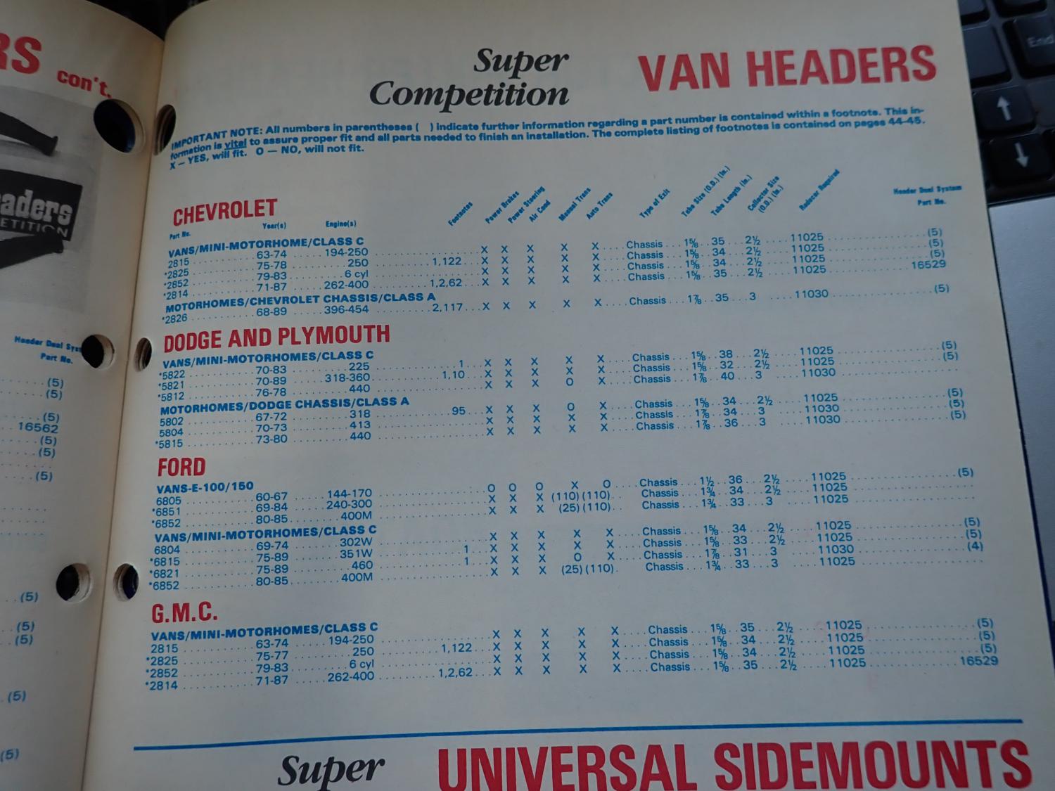

I believe these are vintage G10 van, however, I do not have a vintage catalog with van part numbers in it. Anyone have a Hooker catalog and can help me out? Part number on the flanges is 2821.
