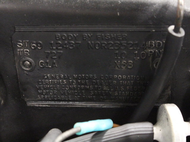

Would like to hear from Kurt S and Jonesy on the trim tag.
I can tell the old ones (pre 2007) from TrimTags.com, but not so good on the newer ones.
What do you guys think?
https://bringatrailer.com/listing/19...maro-z-28-157/
I know there are a lot of things wrong. Engine is too late for a 01A car. Rear stripes are closer to 68 spacing than 69. Not likely a ducted hood car originally, etc.
