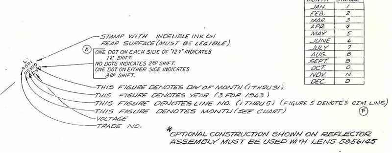

Does anyone know what the Original headlamps for a 1969 Nova are?
I don't hate the rich, And I don't pitty the poor
Attachments - The Supercar Registry T3 date code chart.jpg T-3 headlights.jpg
