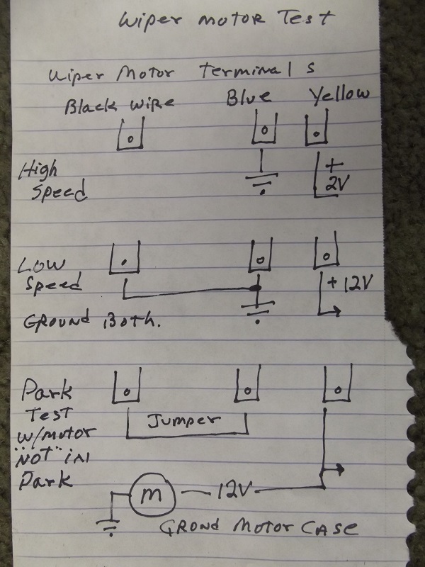

Any words of wisdom out there on where to get a new "park" solenoid assembly for my 67 Camaro wiper motor? High & low speed work fine - park is smoked.
