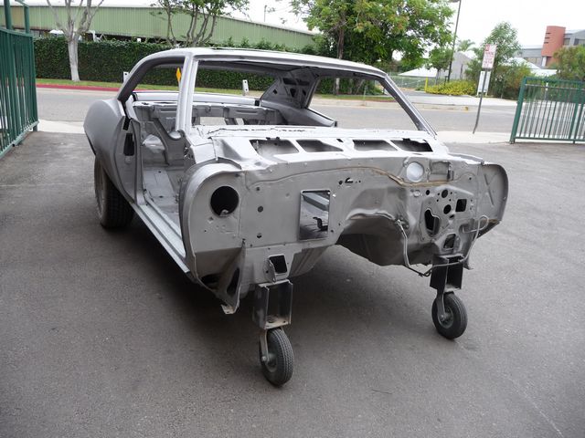

Hey guys...and gals..hehe.....after looking at other dollys that people have made for thier early Camaros, I came up with this setup. I really like it because it can be mounted just on the front if the subframe is removed...or just in the rear if the rear is removed..or both parts can be used together with the subframe and rear removed. I also used all of the factory monuting locations because I know the next car I am going to do is a convertible and I want to make sure all the factory gaps are correct when I put the car together....and best of all, I can hang it on the wall and it is out of the way when I do not need it.I did make a bar that has 2 'u' type brackets that go from the front to the back and slip over the horizontal bars to give support to the whole unit when it is being rolled. The only other thing I am going to do is to add a pull handle in the front...that will make it easier to pull when I am alone.
Feel free to copy it..or if anyone makes it better let me know, just in case I make another.It is a work in progress...
..but if anyone decides to market it...do not forget me if you get rich, ok!! hahaha
