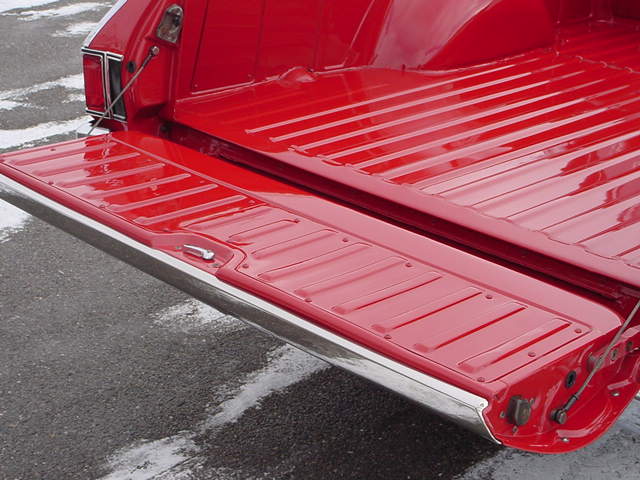

Not sure how well you can see it, but here's how mine was done...masked about 1/4"-1/2" inside the corner.

gate closed.
