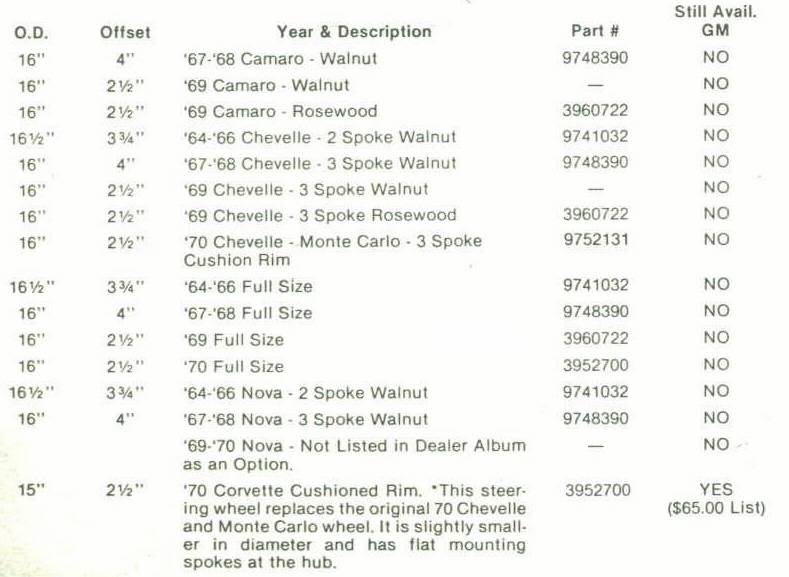

It's my understanding that this is THE correct wheel for the `70 with NK1 option. The one that everyone puts on to replace their cracked one is usually designed for the Corvette.

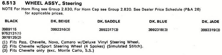

Well, here's what I've dug up so far on this steering wheel from the sources I have:
* P/N 9752131 comes up as 1970 Chevelle & Monte Carlo, and 1971 Full size passenger car, Chevelle, Nova and Camaro "Three spoke cushion rim steering wheel". This part number is listed in the 1971 P&A 26 (Price Schedule) as being used only in Chevrolet models. No Buick usage.
I need to verify the 1970 application though, since I don't have a 1970 P&A.
* The 1970 usage above came from an article written many years ago by Ken Moorehead and the 1971 usage came from the 1971 P&A 30M (attached).
If anyone has a P&A for 1970 showing this wheel, can you please elaborate??
What I'm confused about is the Price Schedule stating this wheel was only used in Chevrolet models. If the Black "Thumb Grove" steering wheel really IS P/N 9752131, and it was used on the 1970-1971 Chevelle AND the 1969-1970 Buick GS, the Price Schedule would reflect this.

Note (2) in the attachment says the sports wheel is 4-spoke!?!?
