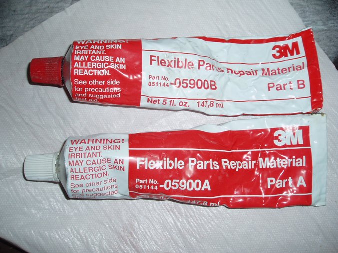

I'm thinking that rubber bumper (endura) repair stuff would be good for this. That's the 2-part epoxy-like material you use to repair/fill holes in GTO-type bumpers. It worked great fixing my rubber coated Trans Am steering wheel.

You might want to try Loctite 495 super bonder part #49550.
It will stick just about anything to anything....including your fingers. It is clear so a repair shouldn't be very obvious. I keep a small bottle of it in the refrigerator. Stores best when kept cool.
