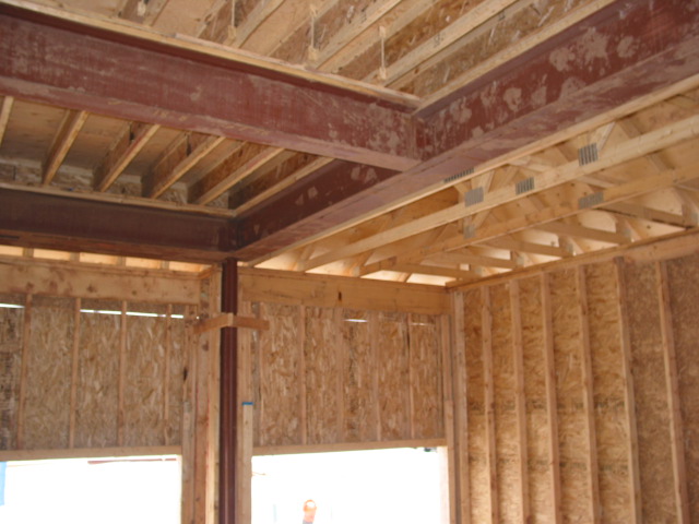

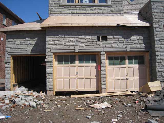

Does anyone have any idea of what it costs to raise garage door tracks up to clear a lift? I was hoping to have the tracks raised on the new house but the builder went ahead and installed them last week before I had a chance to speak with them...

As you can see from the attached pic, I have about 4 feet clear under the ceiling, so I should have no problem clearing the cars with the door once it is raised. I have asked the installation company for a quote, but no response so far...

I wish we had more space here James, but we live in the city and land is at a huge premium. We have no choice but to stack cars with a lift. The two bays on the right are off-limits to everyone else...they get the bay on the left for their junk
