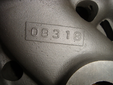

This is a pic of a date code from an "074" head. I thought all the early aluminum GM heads were date coded a similar style?

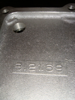

Chevrolet did not necesarily use the same font/numerical styles for casting dates on the same exact type part depending on the date the part was cast(boy was that a mouthful!!)...... for example these are 2 pics of original x-ram intake top plate casting dates which are only one day apart and still very different...
those heads on ebay are almost a year earlier than the others...
Not that that proves anything on the head dates...I'm no expert, but just showing real pics of real parts for comparison...

another

sorry for the bad pics, but you get the idea..they are almost totally different...and only 1 day apart??
