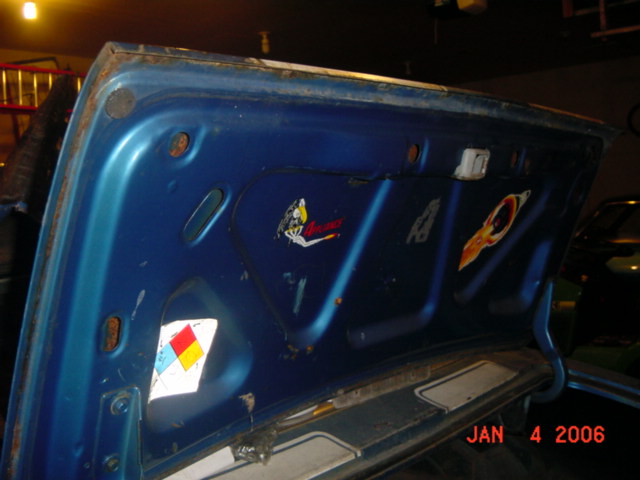

Here is a '67 decklid. Only had holes in teh underframe to mount the emblem, none for the spoiler.
