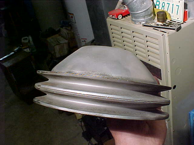

I have a deep groove dual pulley with no number on it. I have this style pulley with the 2 welds on a corvette. I also had another person tell me its z16 but i really dont know.
pulley is 7 inches in diameter and it's 3 inches tall
Here are some pics

Z/16 fan pulley is single groove, that is early version of the 67-8 Z/28, corvette, "245" fan pulley, could be early BB (65-66) vette or 409.

The early BB corvette pulley # is 3864480CV, I think I have had one that was unstamped like the one you have. I have a 480 in front of me, 2 7/8 inches tall, 7 1/8 wide hope that helps.

I'd agree that it's probably an early version of the 245 pulley. But the 245 was introduced for the '64 409, so by the time '67 rolled around, I can't imagine that pulley was in use anymore. My guess would be the only correct application for it would be very early hi-perf '64 409, or possibly even very late '63.
