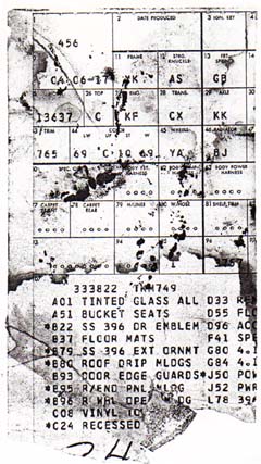

I read a thread from this site from 1999,and was wondering if there was any updated info regarding f40 and f41 useage in 69 chevelles. Ie were both available and if so did the f41 have boxed arms ,and a sway bar etc while the f40 was just a spring shock upgrade any help appreciated

Thanks for the replies. Is there a way to tell on a build sheet if a car had f40 or f41 if the option list portion of the sheet is missing? i have a f41 69 chevelle and another with a factory sway bar but the buildsheet is incomplete where the rpo code would be. im sure a spring box ? or something might show f41??

Boxes 15 and 16 specify the front and rear shocks. TC front and LU rear for at least one COPO and one L78 Chevelle that I have information on. This seems to be the standard shock. Build sheets would probably show the code for F40 and F41 shocks but I don't have any.

My 69 Malibu with F40 has the TC fronts shocks and LU rear shocks on the build sheet. I don't know of another way to determine the suspension option with that portion of the build sheet missing. My 69 SS (all original) 396/325hp does not have a build sheet, but the shock numbers correspond to the TC and LU shocks. I'm wondering if F40 was the default suspension on the SS?
