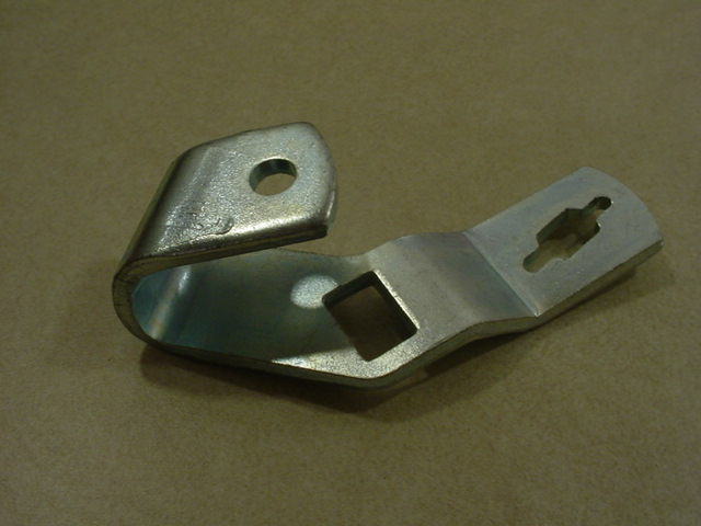

Just finishing up my '69 sYc Chevelle with Hurst Dual Gate. What did Yenko do to activate Back Up Lamps after column shifter was inoperable after Hurst installation. I can't see anything on this car that makes me think they ever were working since the car left Canonsburg. Am I missing something or what ? Thank You

Didn't the neutral safety switch and back-up lights (with automatics) always work off of the switch on the bottom of the column? If the back drive was hooked up correctly everything should still work huh??

steering collar no longer rotates after Hurst install, that's what activates switch..........am I correct on that ?

If Hurst supplied the arm for the side of the trans, that may be true. If a GM shifter arm is used, the back drive will be operational. The shift cable hooks to a pin that bolts into the rectangular hole in the GM shift arm, part #3950176. Check the picture.
