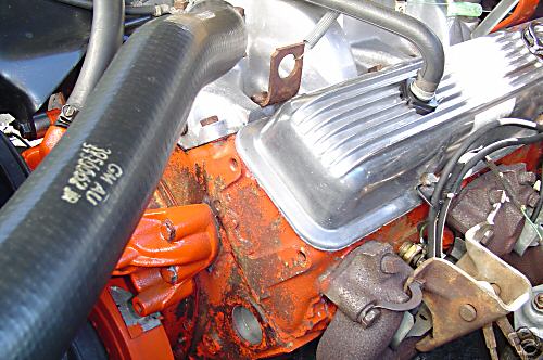

Here's a few I took today. Have a few more I can email if interested.

The lower hose in my pic is also a 561 SM hose like Mike's. No stripe, though. Neither has ever been on a car before, so maybe the factory hoses differed slightly.
What I believe to be date codes on them:
Upper: 6L19A
Lower: 4L30C
