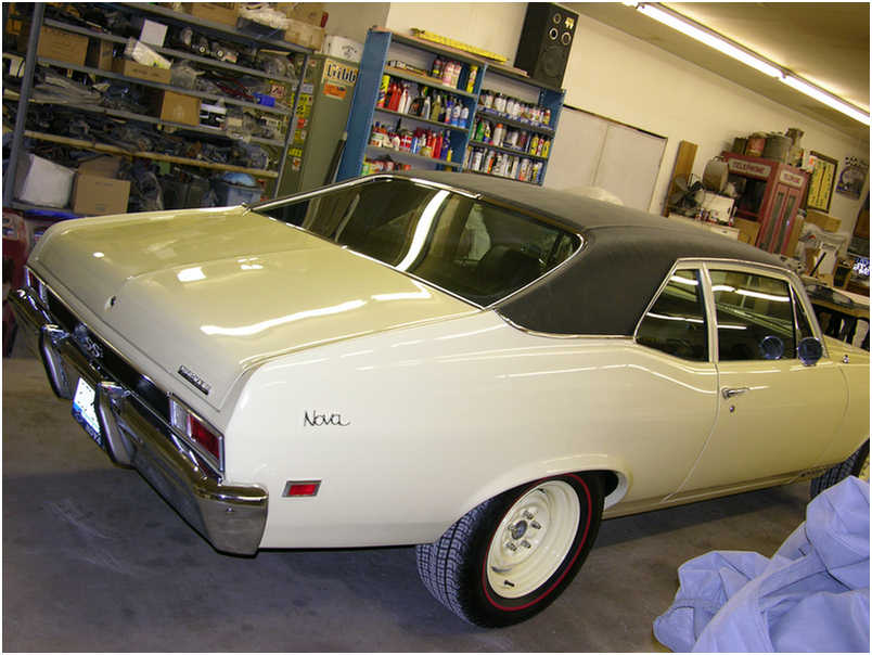

From what Ive read, it appears that XT or IF coded wheels are the ONLY 14x7 G.M. wheels that have the correct appearance for 69 Misc COPO's. Can you please educate me with any other wheel applications/codes that would look correct.
Is there a reproduction available.......?????
Looking for set of FOUR.....14x7 ??????
