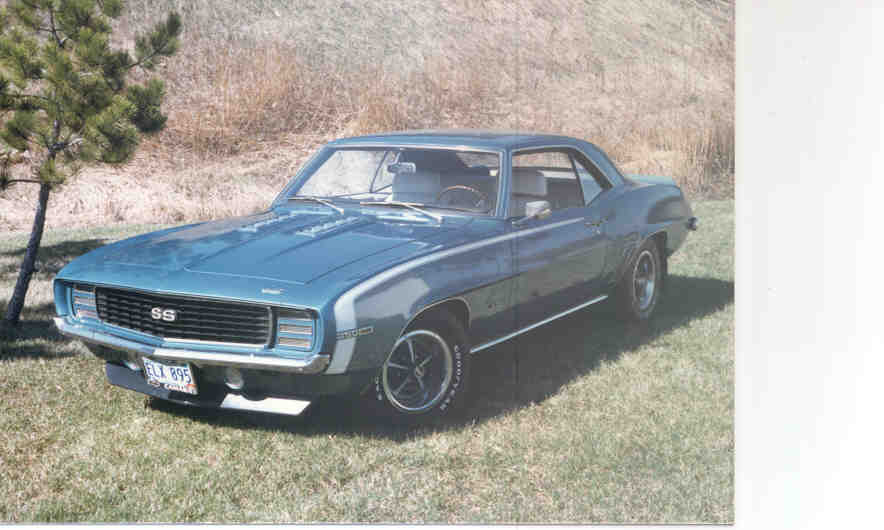

I am trying to find out the correct layout on the 1969 Camaro correct Hockey Stripe. I know that the front fenders are painted on and the doors back are stickers. Here is what I am not sure about. Where the 396 emblem goes on the front fender, is there supposed to be a break in the stripe or is the stripe supposed to be solid and the 396 emblem goes over the painted stripe? I have seen a bunch of pictures both ways and am not sure which is correct.

The stripe SHOULD have the break for the engine ID. Also, there are several parts suppliers that sell a proper stencil kit to paint the fender portions. I've seen too many shadetree hockeysticks that look more like a broadsword or a snake that swallowed a rat. They're almost always TOO FAT. Also, early cars had the fender portion extended onto the lower fender extension. I'm sure I can find some pics. Let me look.

Here's a decent photo for you to check out.

Not the best pics...but proper looking hockeysticks.

Here are a couple of decent side views of the stipes. The pictures are in bad lighting but you can see the stripes decent.
