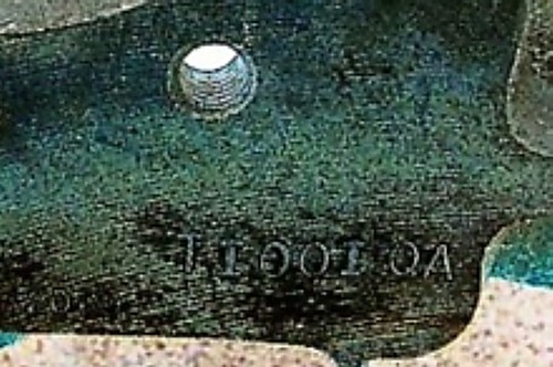

Here is a 63 409 engine...untouched...seems they didn't machine or broach them early on like they did later///anyone know when they changed machining ??...this shows it better

Is this your motor Bob?

I know that all Corvette blocks have broach marks even back in the '50's...I'd say that block has been machined at some point.

Yes Sam and it hasn't ever been machined.

Looks to me like it has been machined.

I was the first guy to pull the pan off the thing...standard bore,factory pistons...can't see them machining the deck and missing the numbers...never been re-stamped unless it was done in the 60's

Could it have been done in the 70's?
I didn't think the circular machines were used until then.

Could it have required additional machining at the factory, before the numbers were ever put on it?

Did anyone give a crap about an original stamping on a 409 in the 70's ? I doubt it...you could still get crate 409's then too...pan has never been off until last night !! Unless someone took a 6 inch sanding pad and gave it a cleaning. The "high" spots in the stampings are a bit shiny...
