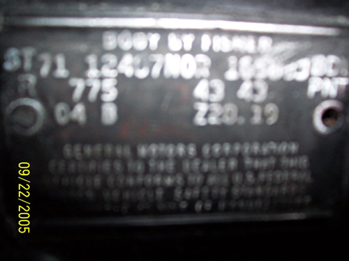

Ask him for all of the codes again. The code break down for the axle is not correct. You don't skip letters to make up the code.
The correct code for the axle CGB077 (incorrect layout) is CG is 3:73.
Matter of fact the more I look at the code he posted on the auction it doesn't look right. The date codes for 71 were month and day not day of the year built.
Also ask him about the shifter and other incorrect items.

077 is the 77th day of the year. Was thinking of something else. But, CGB is not 4:10 gears it is 3:73 gears with Buffalo source.

I'd like to hear your comments Mark. I'm not a 2nd gen expert. Here is a pic of the cowl tag. I'll question him on the 4:10's.
