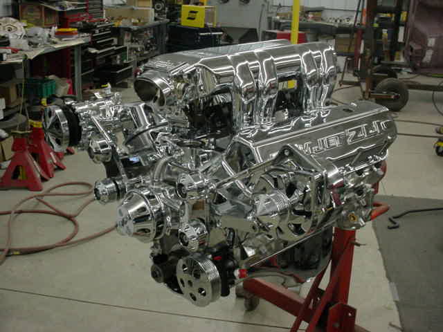

We installed and briefly test fired/ran the new Ram-Jet ZL1 crate engine last Monday in my 69 Chevelle inside the shop...without a load, everything seemed fine. Then, last Friday, we pulled the Chevelle outside the shop under it's own power to set up for a road test mile or two. At high idle RPM while in gear doing a clutch/shift test in the parking lot, we suddenly heard rod noise! We immediately shut it down and yanked the engine to find EVERY rod cap nut was only speed wrench tight [less than 10 TQ] and the mains held less that 45 TQ. The rod/main bearings appear to be the only damage, but with the Memorial Holiday weekend, it'll be Tuesday before new bearings/gaskets arrive for another test run Tuesday evening.

That SUCKS! I would make sure GM picks up the tab on that little brain-fart, and the best case scenario would be to just slap in a new short block...but there's probably not another RJZL-1 short block within 500 miles! I wish ya all the luck in the world...
