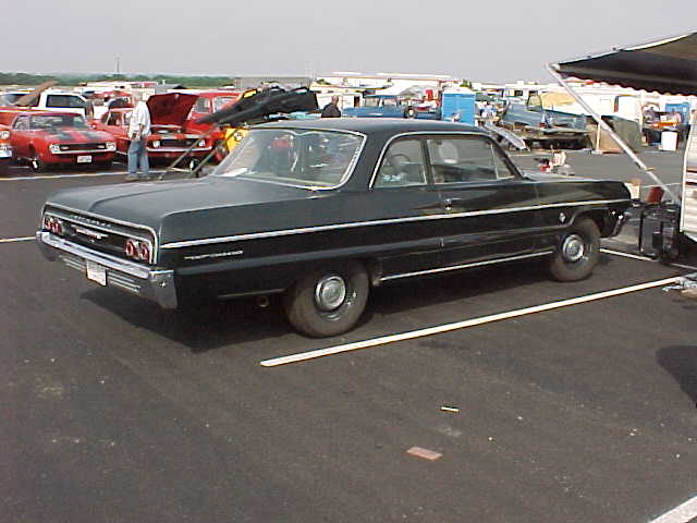

I just bought a 64 2-door sedan with the 400hp 409. It has a heater and radio delete in pretty good shape The problem is the original block is it the trunk so I am going to need alot of motor parts. Thanks for the help

Here is the Green Machine he bought for those that are interested.
