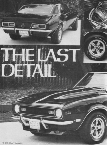

Default Re: 69 SS Z28, RS
it's a supposed SS/Z28
This became popular in the late 1970s and early 80s, before the restoration craze took hold. Look at any Car Craft or Hot Rod mag from that period and you'll see "SS Z/28s." The "SS Z/28" is one of those urban legends of the car hobby that isn't true.
Here's a '68 "SS Z/28" from the 1980 Car Craft Camaro No. 2 special. SS gas cap and Z emblems = BOGUS! Guys saw cars like this and the myth took off.
