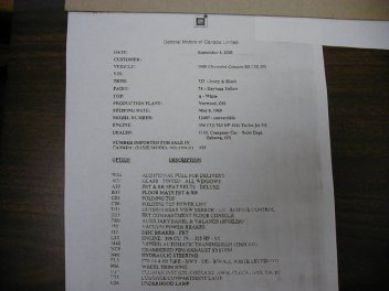

Jeff,
I just received GM documentation of a Canadian imported '69 Camaro 396/325 convertible, Daytona Yellow with white houndstooth interior. Seems that Canada did get converts with deluxe houndstooth interiors, definately rare though.
Mark
