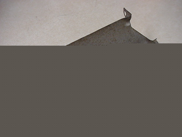

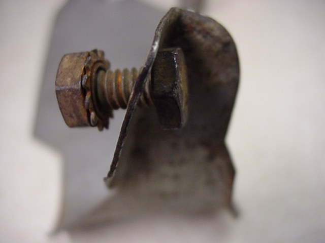

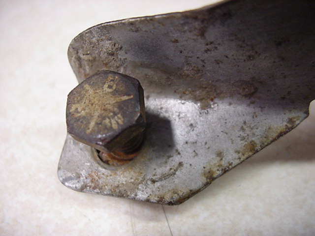

I need to enlist the assistance of any of you who can help
me verify the validity ( existance ) of an original starter
heat shield used on the '69 SS 396 Camaro's & Chevelles.
According to a well known author, the '69 big block Camaro's
used a starter heat shield. I have as of yet to see one
original car with one intact. That doesn't mean that they
don't exist. I am closing in on the final stages of my
SS 396 Camaro restoration and I very much need to know if
this heat shield was used in production. My car was built
10-D-68.
I have been told that the heat shield in questions was both
steel and stainless steel. Which was it? The Corvette guys
tell me that the BB Vette had a stainless steel shield, but
it was used only for the BB Vette. If this heat shield does
exist and it in-fact a true original part, can any members
here post a picture ( or five ) showing exactly what it
looks like? Also, I need one and if any members have one or
know of where one exists, kindly let me know.

I have an 06D built L78 Chevelle that has the shield. Looks just like Belairs, only not as clean. I don't think my starter has ever been taken off.

The shield was polished stainless steel (the more reflective the surface, the better it reflects heat). My 69 SS RS 396 conv. still had it on when I bought it in '79. It is a 10A 68 car.
There is absolutely no question the heat shields and parts similar were "lost" along the way. I worked in a service station in the 70's and know first hand that many parts like these were trash canned.
The GM replacement has been galvanized steel for years. I believe the polished stainless shield is now being reproduced.
