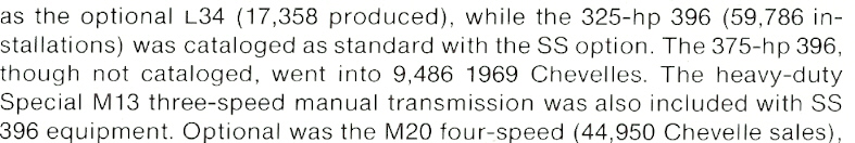

This is a question that came up months ago on another board with no definitive answer and for some reason I just thought of it again. This is relative to Chevelles. Was the base "Special Three Speed Manual" the standard tranny for a 69 L78 Chevelle? It was standard for the base L35 and optional L34. I have one source book (not the most reliable) that says the 3 speed was still the base tranny on the L78 Camaro and it makes sense it would be for the Chevelle as well. Can't say I've ever seen one first hand, but feel it was.
Appreciate any input.
