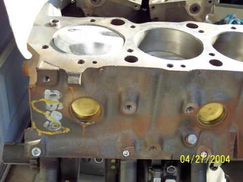

Does anyone know what years did the LS-7 crate motors run from - to? How about L-88's? Would GM have used a 14015445? Does anyone know what the GM part number would of been for either the LS-7 or L-88? Would the short blocks have been painted?

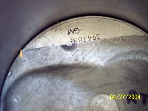

Found a brand new GM short block with pistons having a casting number "3947886 GM" stamped on the top. The block is not painted or stamped but has unusual multi-color paint markings all over on the block, crank, and rotating assembly. There is a cam present, but I have not pulled it yet to view the p/n. I also need to look at the crank p/n.

Are you sure you that engine is an LS7? If you look in the lower right hand corner you can see it indicating its a 4/27

It's a LS7.Check the casting date on the block and 990's.I bet it's around mid 80's.There should be a off road use only tag if you took it out of the crate.I bought a couple of the last L-88's in 1980 and the blocks were 289 castings 454 blocks dated 1973.

The casting looks like a 1978 but I am going to check further. There are three sets of heads, 1st set are 3946074's with "9.7.71" and "1.3.69". and 2nd are 14096188's with "F130" and "G090" and last is a set of 6272990's with "B-26-74" and "C-1-74". The 074's and the 990's are assembled and the 188's are bare. The 074's have been used but briefly. Here's the casting date on the block.
I have a feeling that this motor will rock!
My next quest would be pull the cam and check the number and I may have to check the crank.

Here is the piston casting. Someone has said it could be a ZL-1 casting number.

I have a set of std ZL1 GM pistons and the number on them are GM 3981890.
