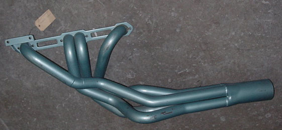

This is what an NOS set of factory headers looks like. This is the driver's side Bill Thomas style used in '67. Stahl headers do not have the same pipe bends as these but use the same (or similar) style of flange at the cylinder head interface.
-Jon
1967 Z28 street car
1967 Z28 Trans Am race car
1967 Z28 Registry
