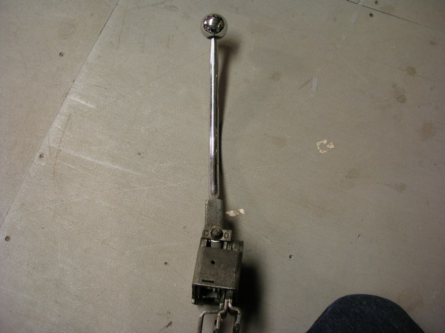

I am looking for info on the Deuce 4sp Hurst shifter.
Anyone have a picture of a Yenko Deuce Hurst 4sp shifter?
Did it use same shifter body as 69 Camaro or 70 Camaro?
What is the number stamped on shift handle?
thanks

JoeC;
Same shifter as a '69 Camaro, 9hole GM bracket, BB shifter rods (reportedly), and Pontiac GTO/Tempest bench seat Hurst arm #4177.

Joe,
Not too good but here's a shot of Tommy K's car.
DC
