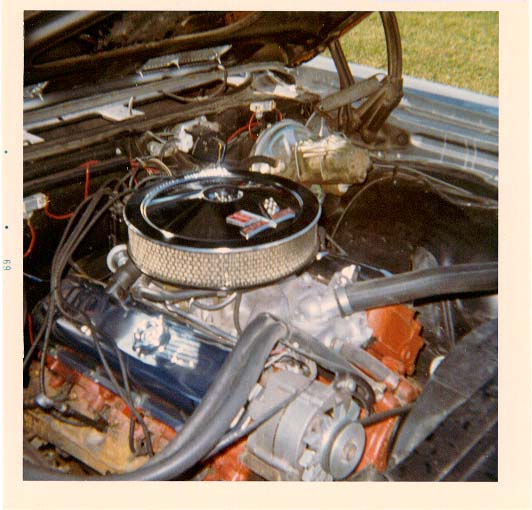

The 427 L72 was released in the 1966 Model Corvette and rated by the factory at 450hp in the early car and 425hp in the later cars. Same engine different rating. The L78 /396 was also rated at 425hp for the '65 Corvette.
While I certainly can't speak for the man, I would speculate that Don Yenko who was very familiar with the Corvette Engine used GM's own marketing specs. and Dyno Results to rate his Super Cars.
It was after all the same L72 over the counter blocks which Yenko Sports Cars Inc. began installing between the fenderwells of their first Camaro Super Cars.
Just My opinion and observations.

OK so what was on each Yenko Camaro air cleaner lid in 1969 ? 425 horse,450 horse or nothing ????

Our last L-72, built EXACLTY as the factory did it (10.2:1 compression ratio) in 1969, made 425hp on the dyno through the stock exhaust manifolds and head pipes.

The Yenko Chevelle tested in SSDI in '69 didn't appear to have any breather decals.

Keith, is that the definitive answer? Did all Yenkos and COPOs have no any decals? Just have crossed flags decal? or both crossed flags and 425HP decals?
