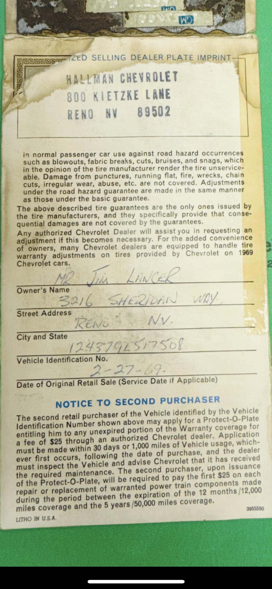

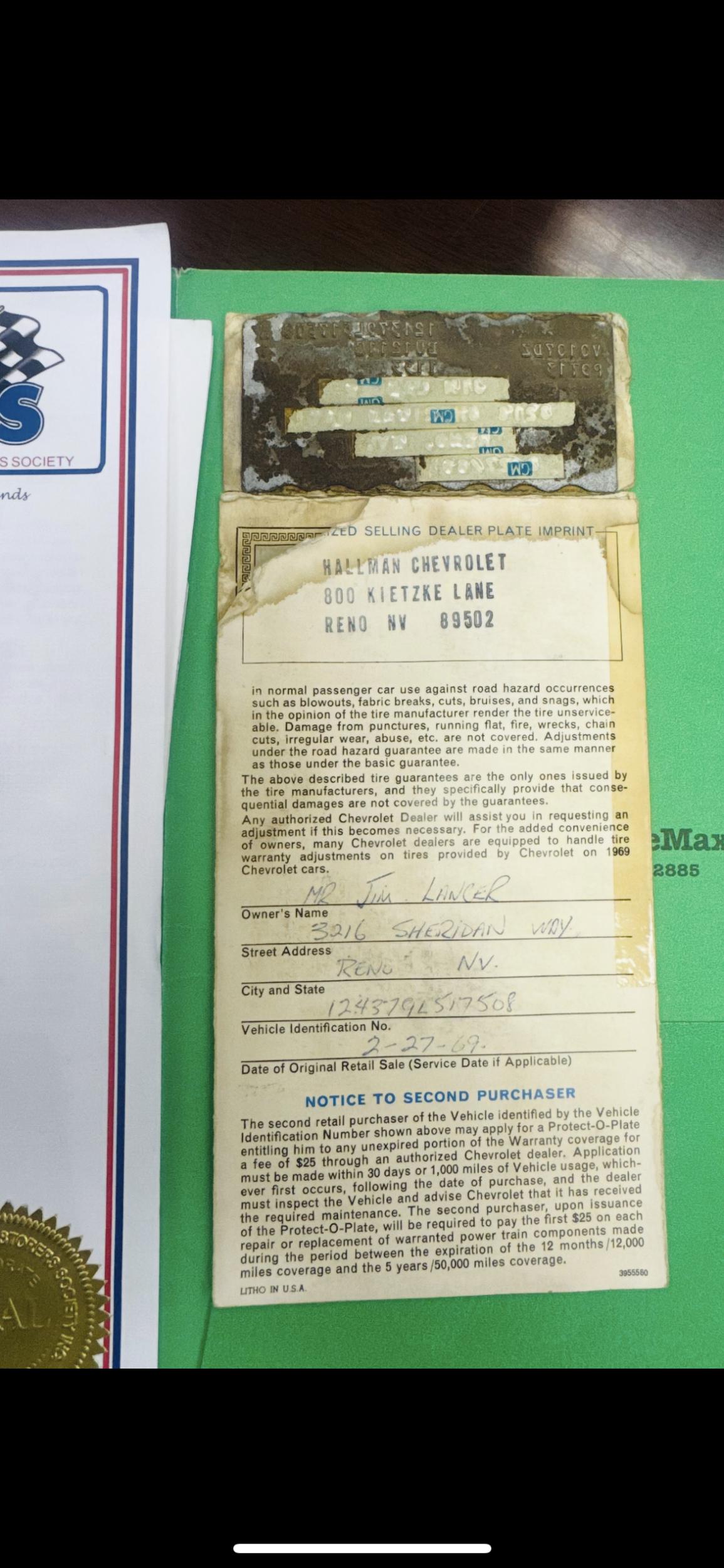

Default No idea what is going on here...
https://www.mecum.com/lots/1159642/1...aa_id=726450-0
Reported VIN: 124379N526710
From the hard card:
Original matching numbers 396/375 HP L78 V-8 engine
Engine never taken out of the car
Original retail order
Window sticker
Also consigned to Mecum Kissimmee 2016, no sale.
POP was on eBay Sept 2024

Must be the L78 version 327. Somethings not right

BP ---- 273 10 bolt --- goes with the 210 horse -- LOL

I certainly appears someone has been caught making up a car with a story to match. Probably had no idea the POP would surface one day.

Rare 1 of 1!!! Flint-built 396/375 HP L78 V-8 engine!!!

Be interesting to know if the current owner bought it to remove it from circulation and hide the truth. Good thing people have a pic of it saved for evidence.
Has anyone alerted Mecum to this development ?
