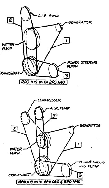

  #12
Old 10-20-2025, 01:23 PM
1967 4K's Avatar
1967 4K 1967 4K is offline
Join Date: Jul 2012
Location: Ky.
Posts: 1,129
Thanks: 4,442
Thanked 1,135 Times in 345 Posts
Kurt, a few trips to the NAPA store to get one the right size. Take the two groove water pump pulley off put the belt in the grooves then back on the pump n line up everything. Kinda PITA.
Not sure what GM’s thinking was there but if I break an alt belt I can still get back home because the water pump is driven by the center belt. Hope my battery holds charge that long. LOL 😆
Richard
1967 Camaro SS 396/375 4K
  #13
Old 10-21-2025, 02:18 AM
169indy's Avatar
169indy 169indy is offline
Join Date: Oct 2001
Location: Washington
Posts: 830
Thanks: 1,221
Thanked 808 Times in 264 Posts
Default 67 V8 Camaro 3 groove cast crank pulley AIM data
V8 Belt Tracks for (THREE) Track-Groove Crank Pulley's
UPC 6 Source
69 Los Z11
68 SS/RS 396/325
68 Los Z28
