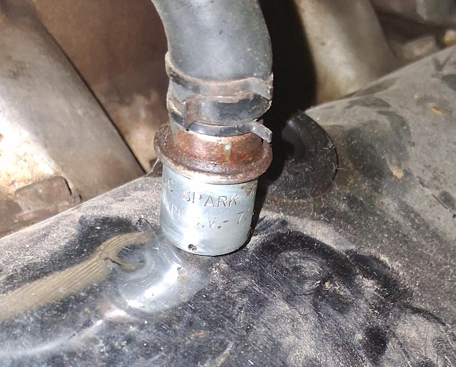

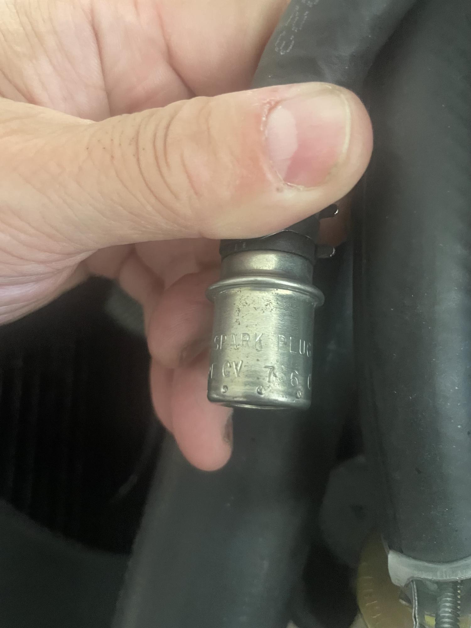

Does anyone have any solid authority about the type of PCV valve that was installed at the factory on BB 1969 Camaros? The input I have so far varies but most are advising me that my car should have a "spun" AC CV746C - photo below.
Thanks in advance for any input so I can strike this from my to-do's before Legends judging next month at MCACN.
Jim

Only Z/28 used the 746.

Henry did not bad mouth it and we never looked further.
Baltimore Feb 69 Chevelle.
Have seen a few replacements but the markings are different.

I have a replacement 736 and see some differences as you noted..

Going to give Henry [R.I.P.] the nod on this as it and MANY other details were requested by him.
Several threads full of his requests on this minutia on "OLE BLUE".
He requested pics of this and only said "you are lucky that is still there".
We did not pay any more attention to ours but of course looked for more and noticed they were not exactly the same.
Replacements seem to take several forms.
Have found exactly zero wiper blades to match the factory ones still on car. Another Henry detail and sadly he passed on.
Never got to give last report and get new list of stuff to look at.
RIP Bud.

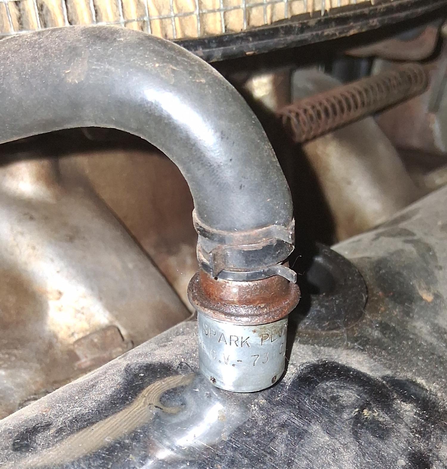

Found this digging for stuff.
Says it is 1967 Corvette??
I would think it is just the earlier version as it is same number?

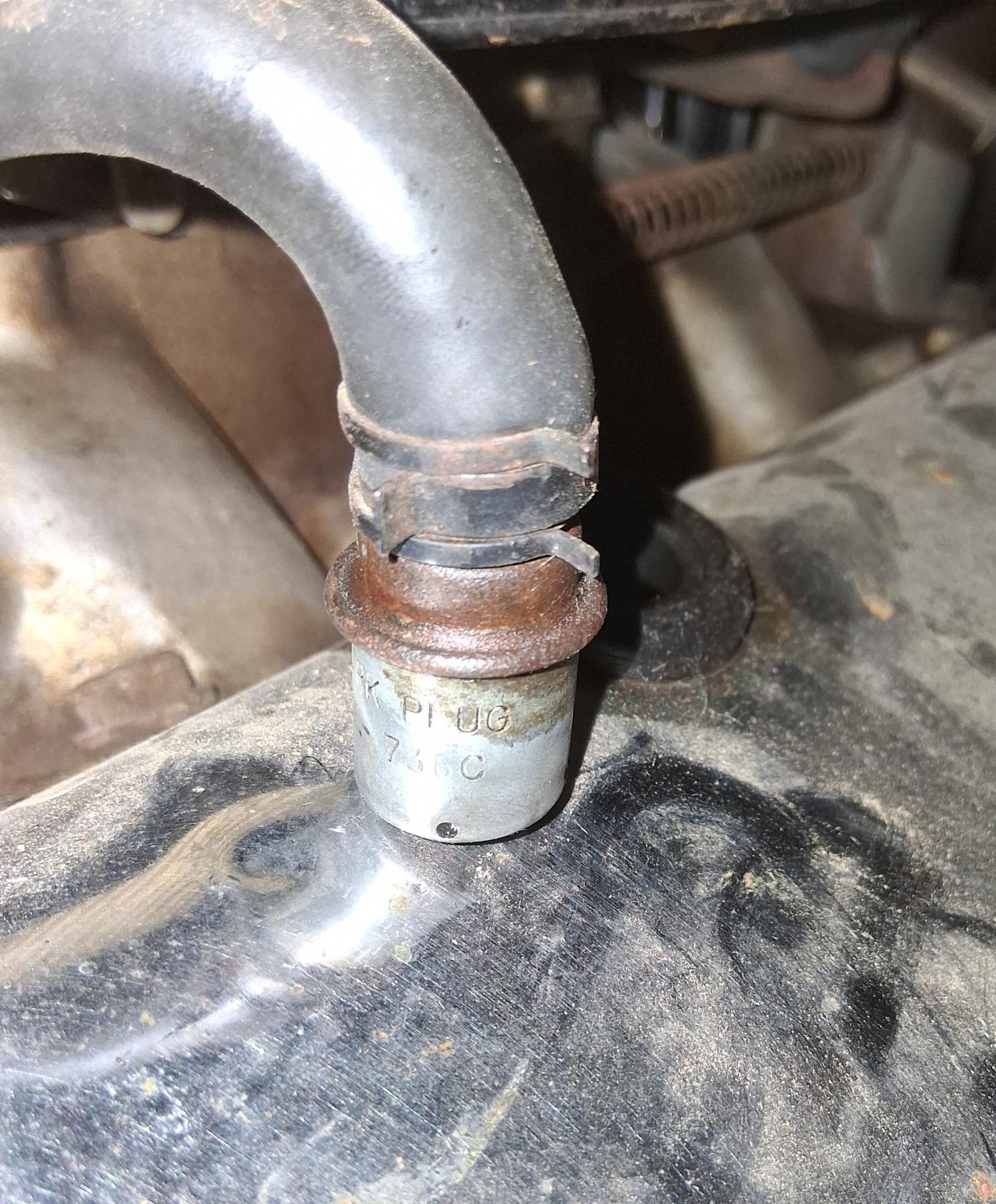

Found more.
Top 2 pics are a crusty used one.
Bottom 3 pics are repop.
Cannot see GM line people opening boxes to cee if early or late 736's
Early-v-late imho.
Pretty sure hers is the one that came with car.
Henry did not take issue with it and he was all over this stuff.
THOUGHTS??
