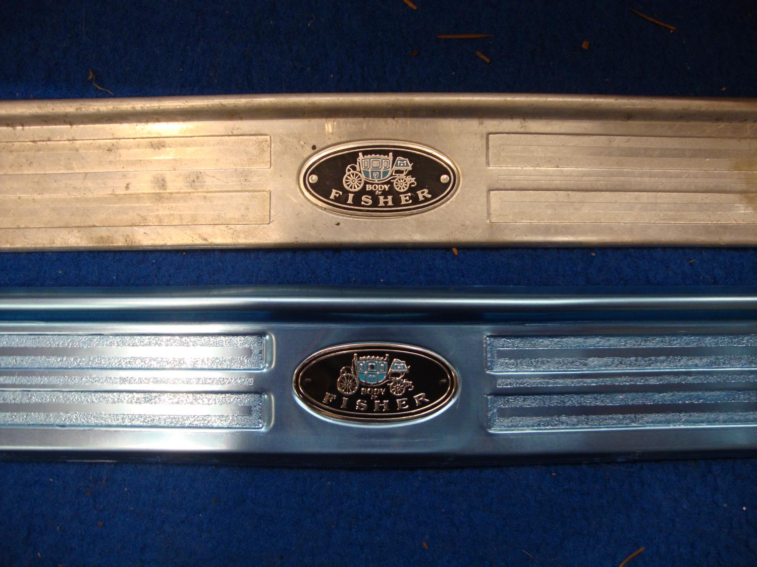

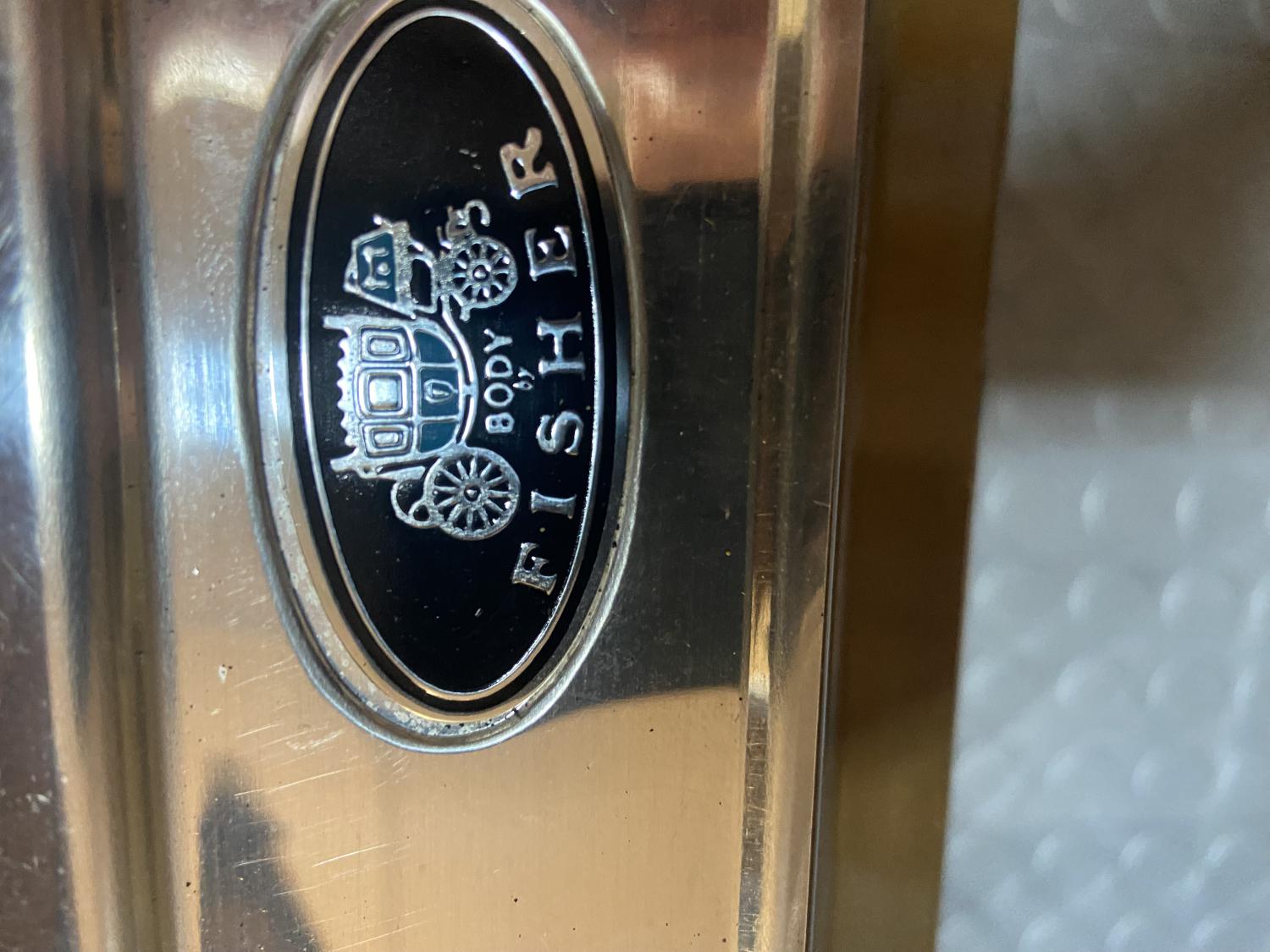

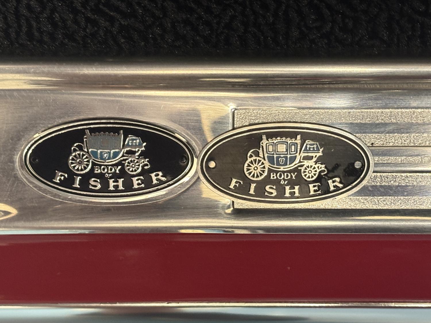

The re-pop sill plate have the rivets ( fake), but the Fisher tags are so incorrect.

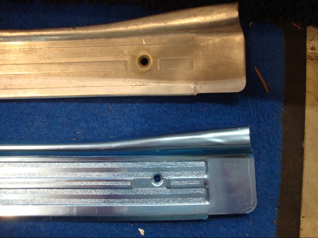

Thanks for the tutorial Greg - nice work! The OE sill plates for my car have contours that are quite a bit different than re-pops (not to mention that the re-pops are nearly as thin as tin foil). Also, all of the rivets that I removed are hollow in the center. So, I think I'll try polishing the originals & reattaching the rivets......... To be continued
see picture - re-pop is the sill plate that's installed.

unpainted (Factory F body) -vs- painted (Trim Parts Repop)
I wonder if they came both ways.
& the Repops are narrow on the rear pinch weld cover interfacing
69 Los Z11
