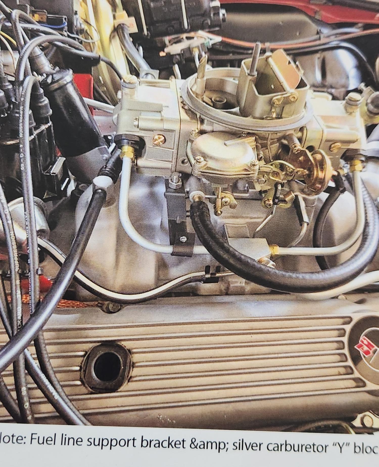

I could be wrong but I thought ‘69 used the support tab off the fuel block
therefore not needing it.
In ‘70 with all the changes, intake, they eliminated the “Y” block support and added
this support.
I believe the Corvette used a different Brkt same affect but different.

Hi Joe great catching up at Camaro Nationals. The bracket as I mentioned was introduced around June of 69 and have found on many original cars built in that time period. This is picture from the Legend Judging manual for illustration. I know it has been discussed on this site and shared pics of originals on cars. Hope this helps.

There ya go, guess when I bought both the judging books I should probably set down and read them.
Thanks Steve
