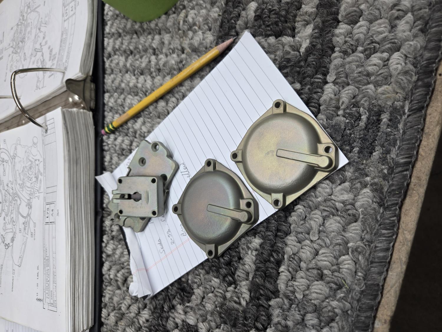

I feel pretty comfortable as well with my research on carb Chromating. I can do the lighter yellows all the way to the darker greens i commonly see on say 66 or 67 Chevelle BB carbs.
In the spirt of making sure this info doesnt die, PM and I will gladly share how to do it, including materials.
