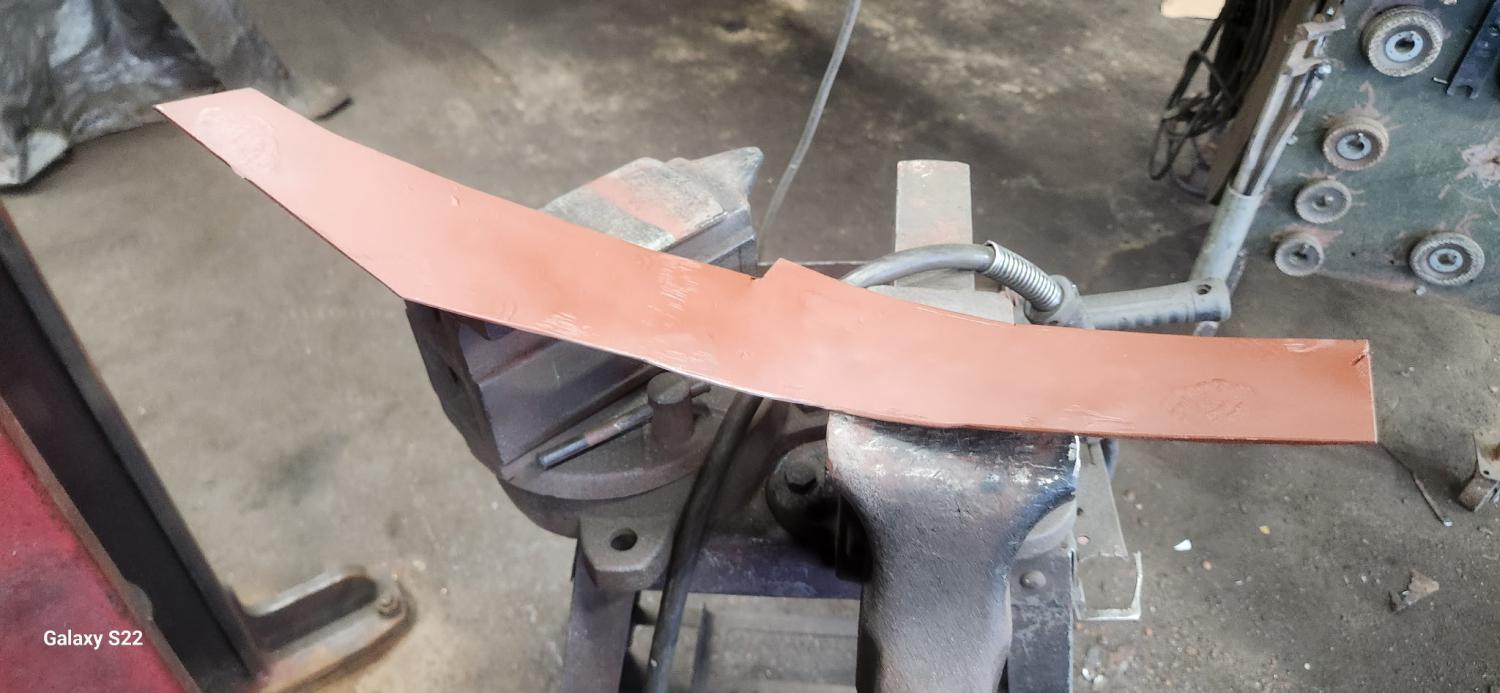

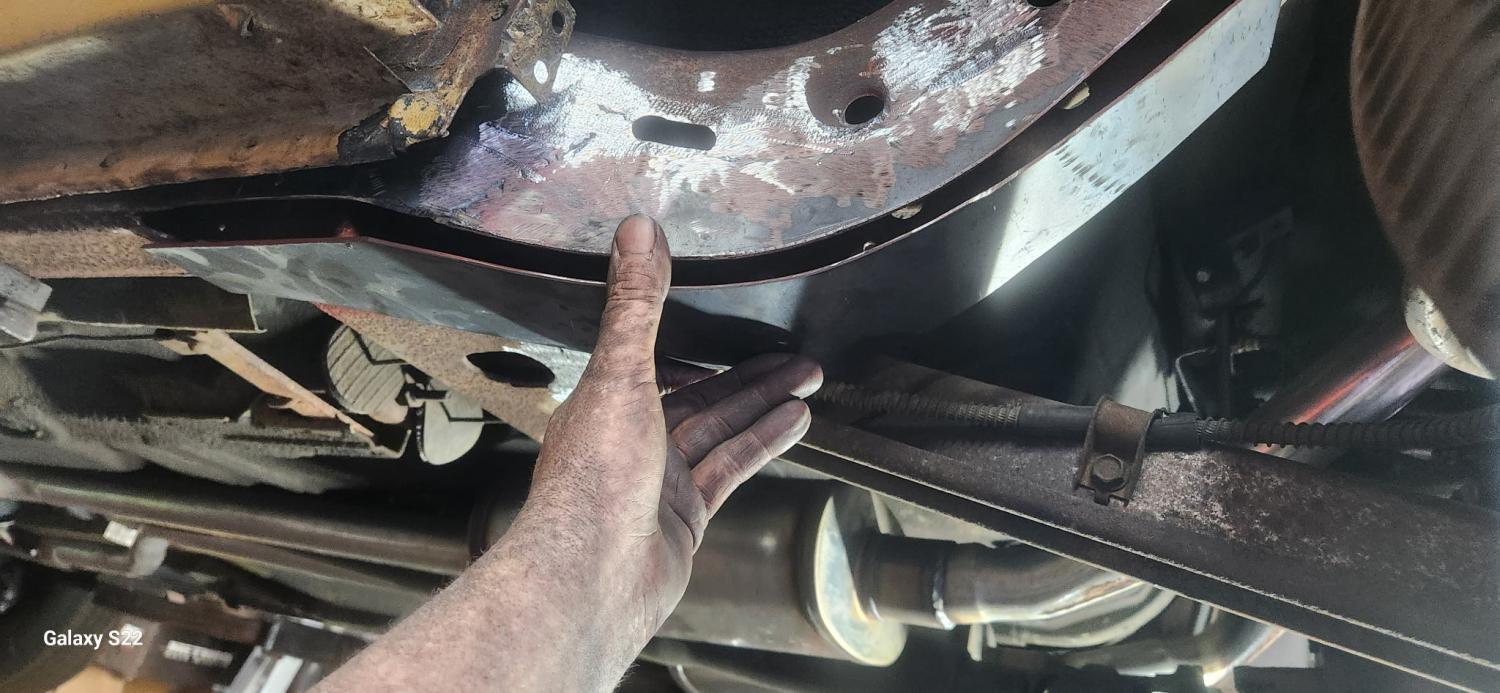

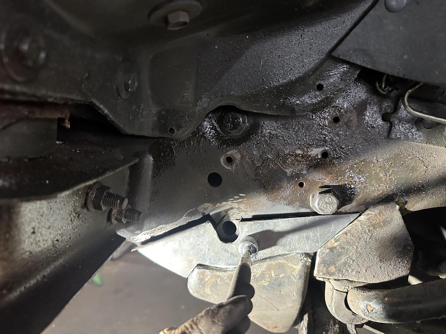

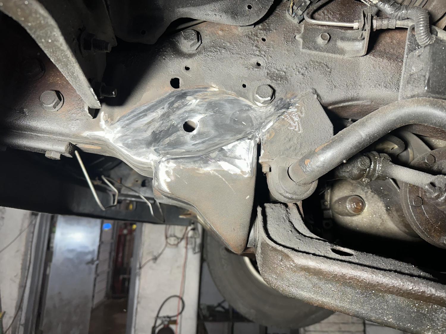

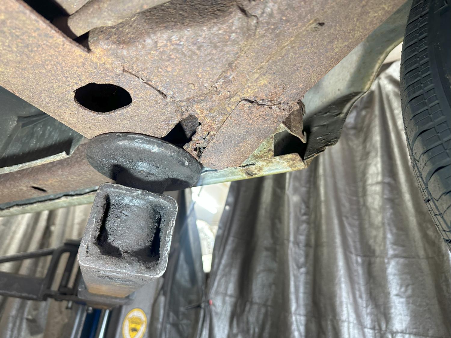

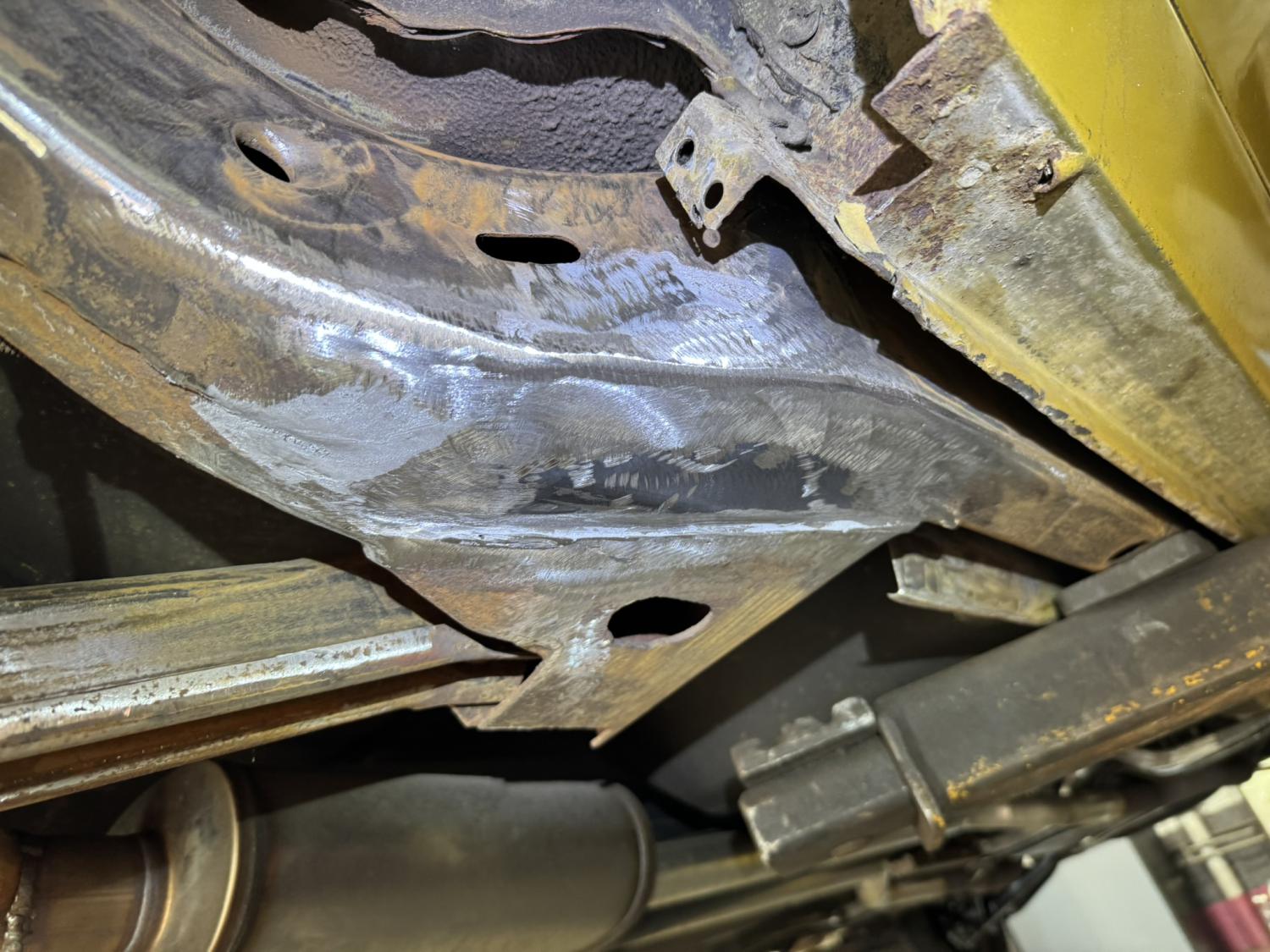

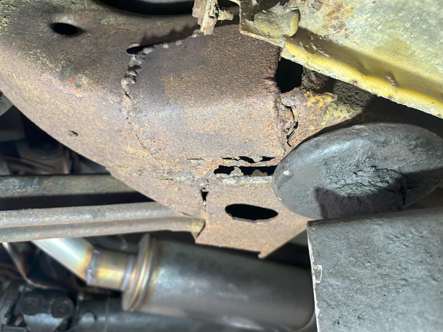

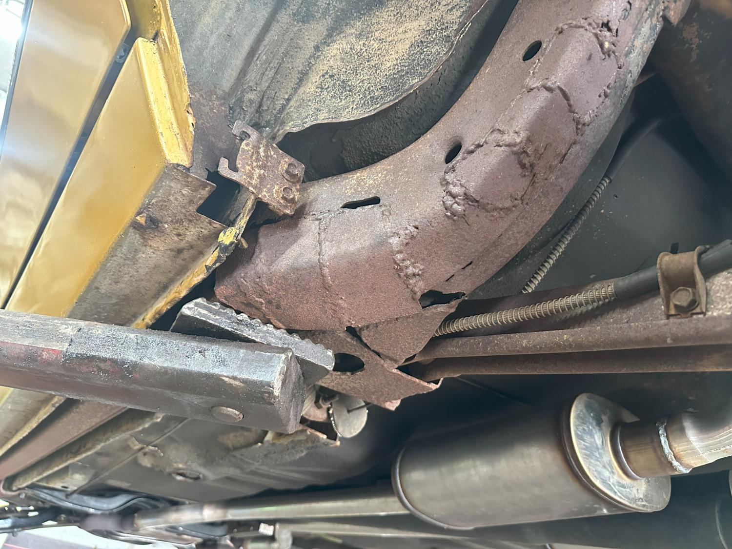

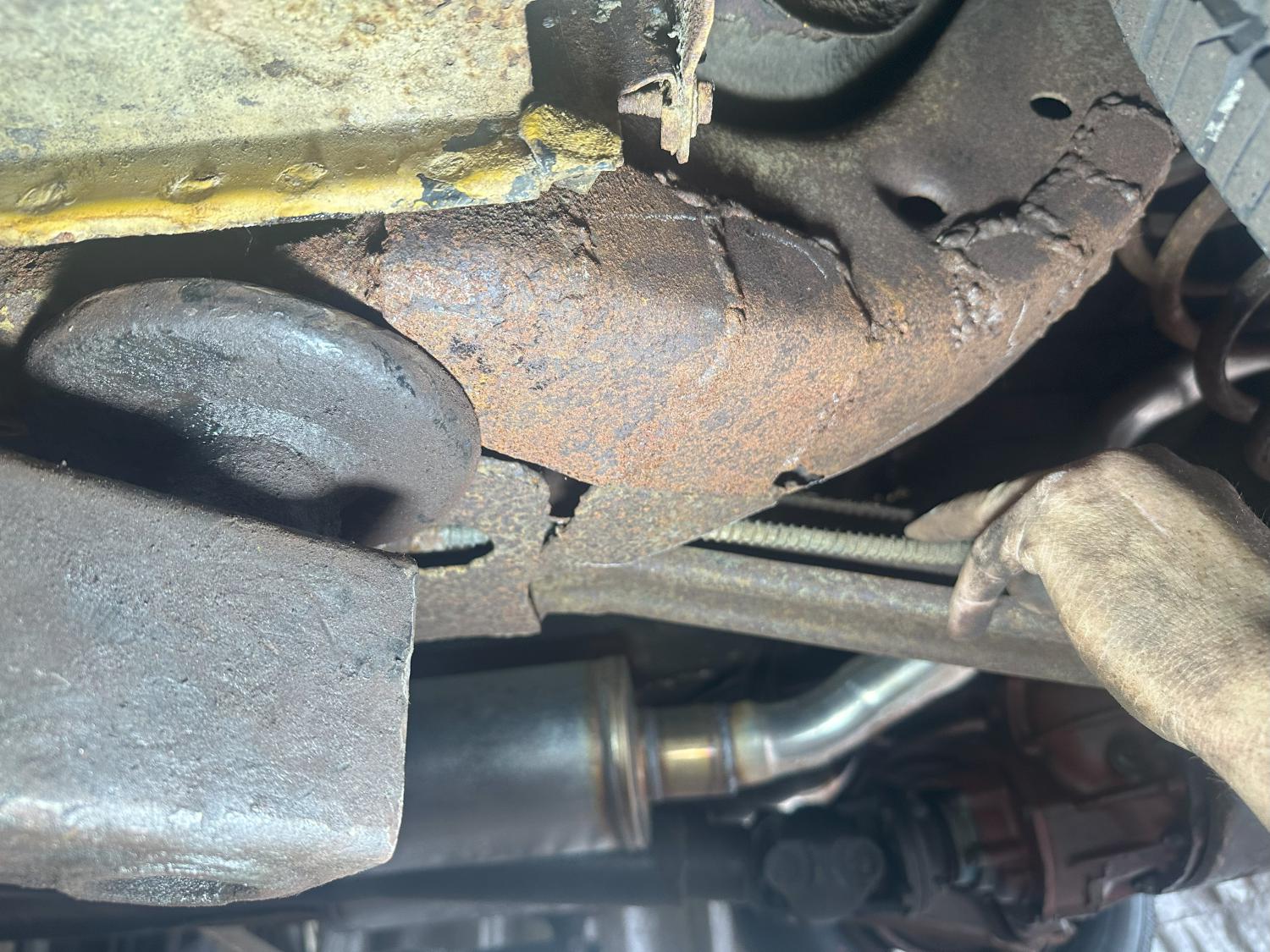

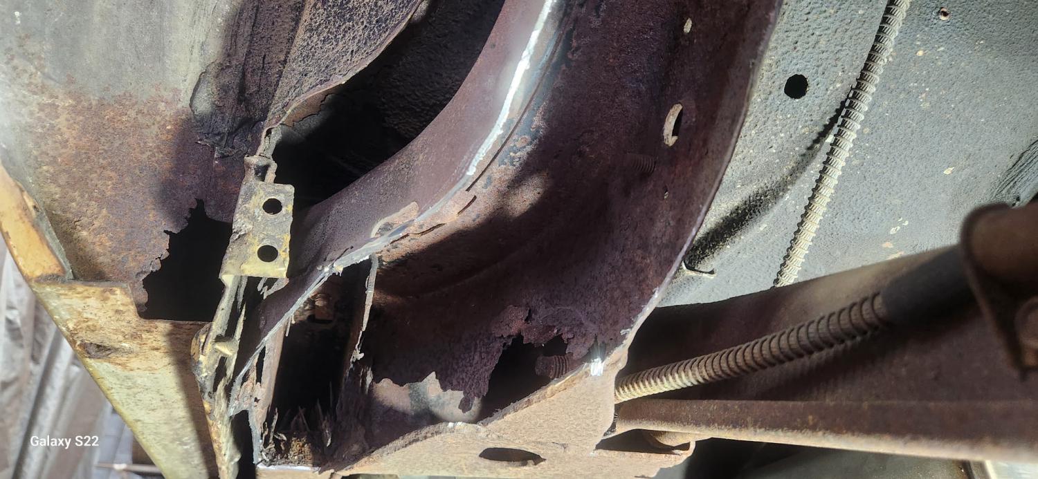

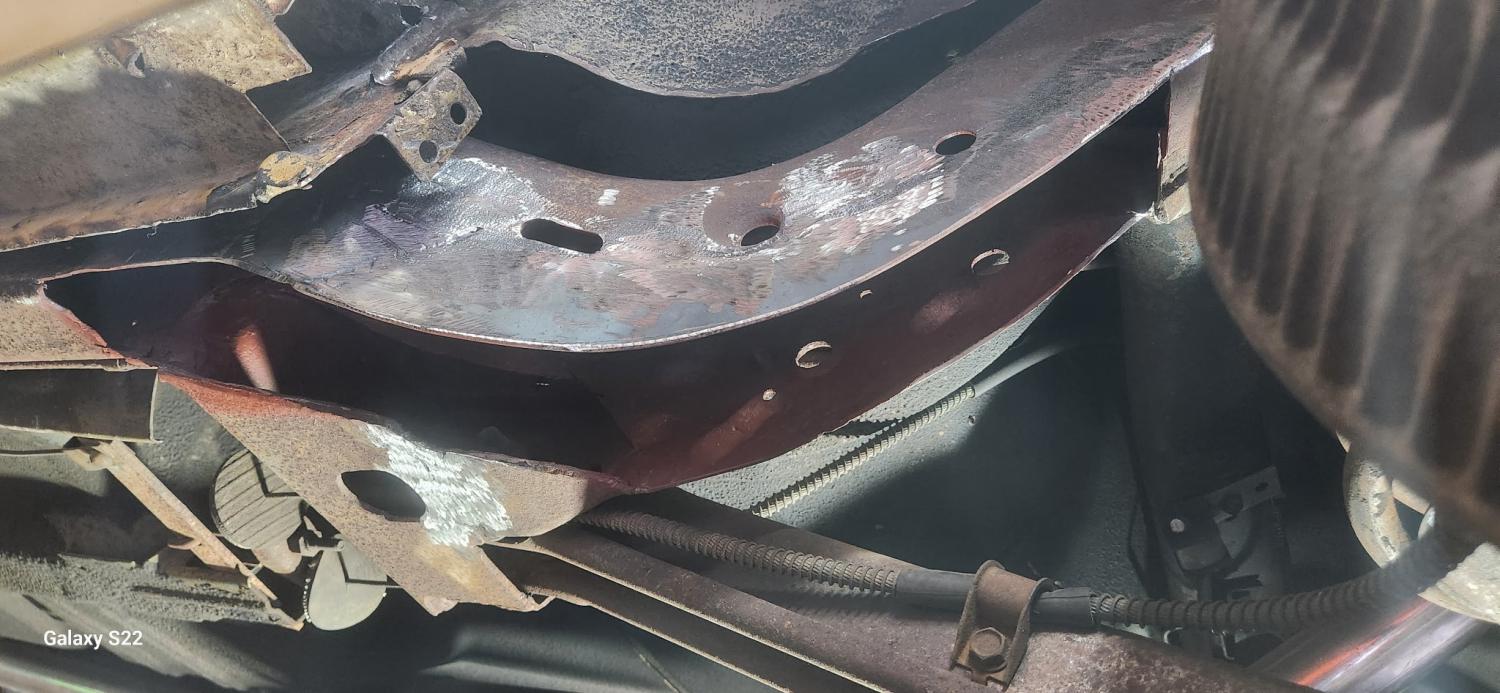

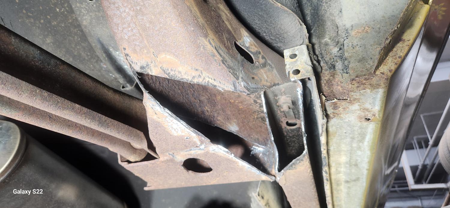

I finally had the sketchy frame repairs that were done 33 years ago properly repaired. These battleships tend to hold water in the rear frame rail kick-out area (same spot as mid-year Corvettes). When the car was repainted back in 1992, the body guy used a stick welder and some metal brackets to make slap on patches which her then welded to each other like fish scales. Worked for three decades.
We have a local shop (50 miles away actually) that does absolutely amazing frame repairs. Their main job is WoolWax undercoating but they have a side business that started when someone posted their work on a Toyota FJ Land Cruiser page. Now they have FJ's from all over the country on a waiting list for the frame repairs. Garden State Undercoating: https://www.facebook.com/search/top?...20undercoating
Contact info: Chris at Garden State Undercoating, 126 Route 46 , Saddle Brook, New Jersey (973) 343-9775, [email protected]
Here's the product page for the woolwax itself. You can buy it from them in bulk. https://www.woolwaxusa.com/

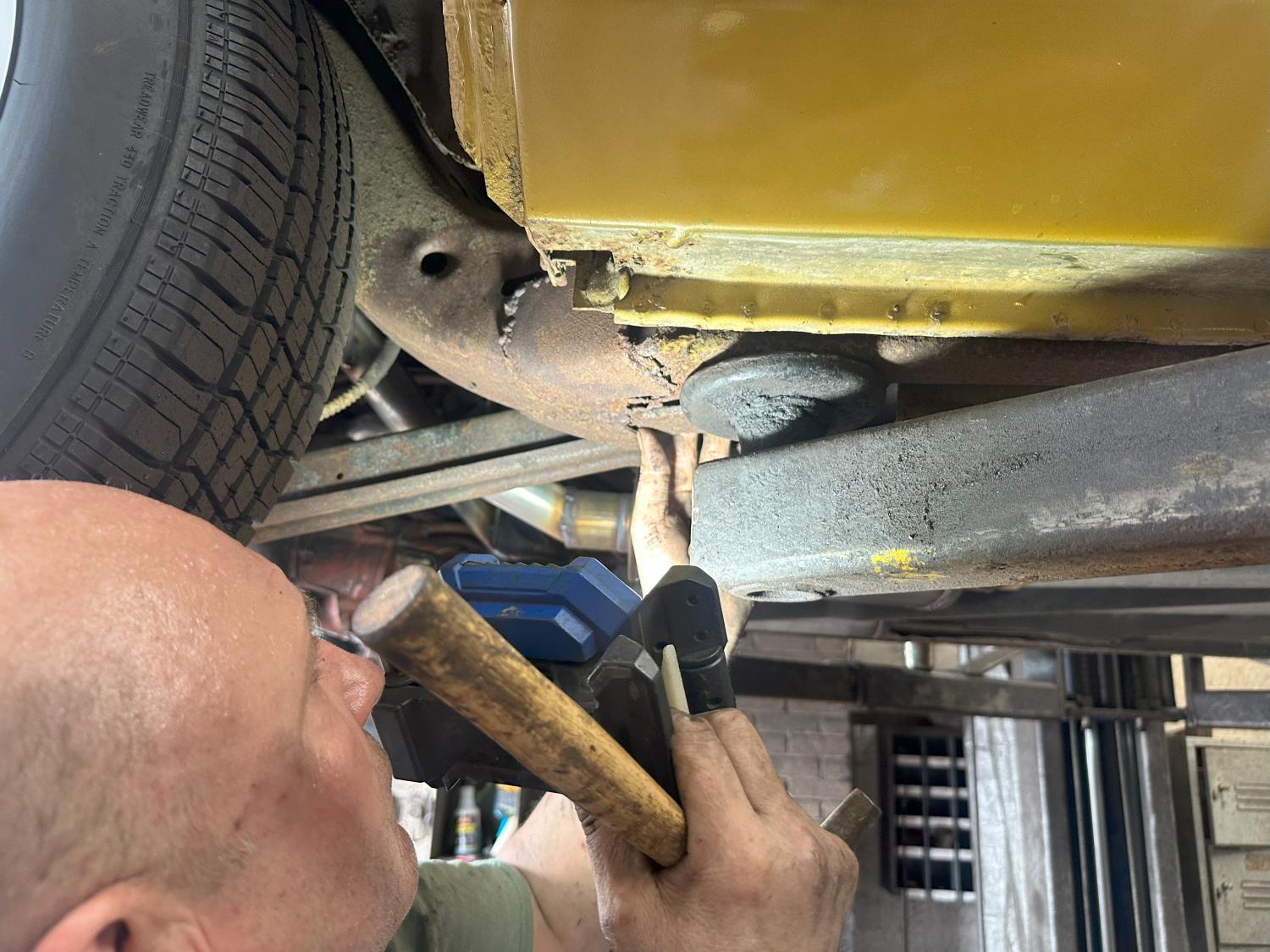

They main welder is a retired Ukrainian tank mechanic. Watching this guy work is mesmerizing. It's like a balloon animal artist at a kid's birthday party. He cuts out the bad area, just looks at the missing space and then miraculously hammers out exact duplicate patches. He's like a human CNC machine.

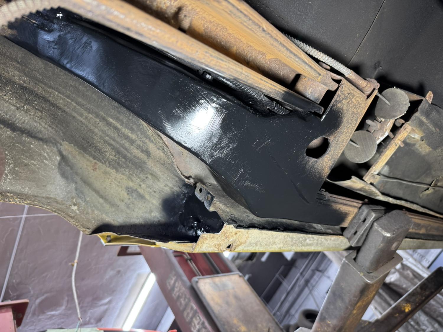

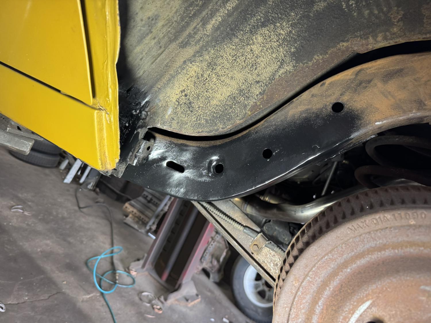

They repaired/welded/primed and painted both frame rails and one hole in the driver's side wheel well by the rocker panel, in a couple days and then wool-waxed the entire underside after wire brushing and sanding the entire frame.
I'm glad I finally did it because it turned out that the only portion of those areas remaining were the fish scale repair patches. The underlying rusty frame spots had totally dissolved to dust.
Here's the driver's side which was much worse than the passenger side.

  #203
Old 07-18-2025, 02:09 PM
njsteve's Avatar
njsteve njsteve is offline
Join Date: Nov 2003
Location: NJUSA
Posts: 8,483
Thanks: 9
Thanked 2,975 Times in 916 Posts

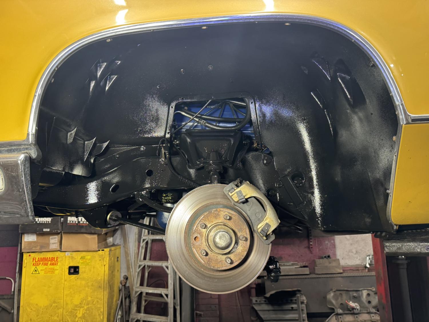

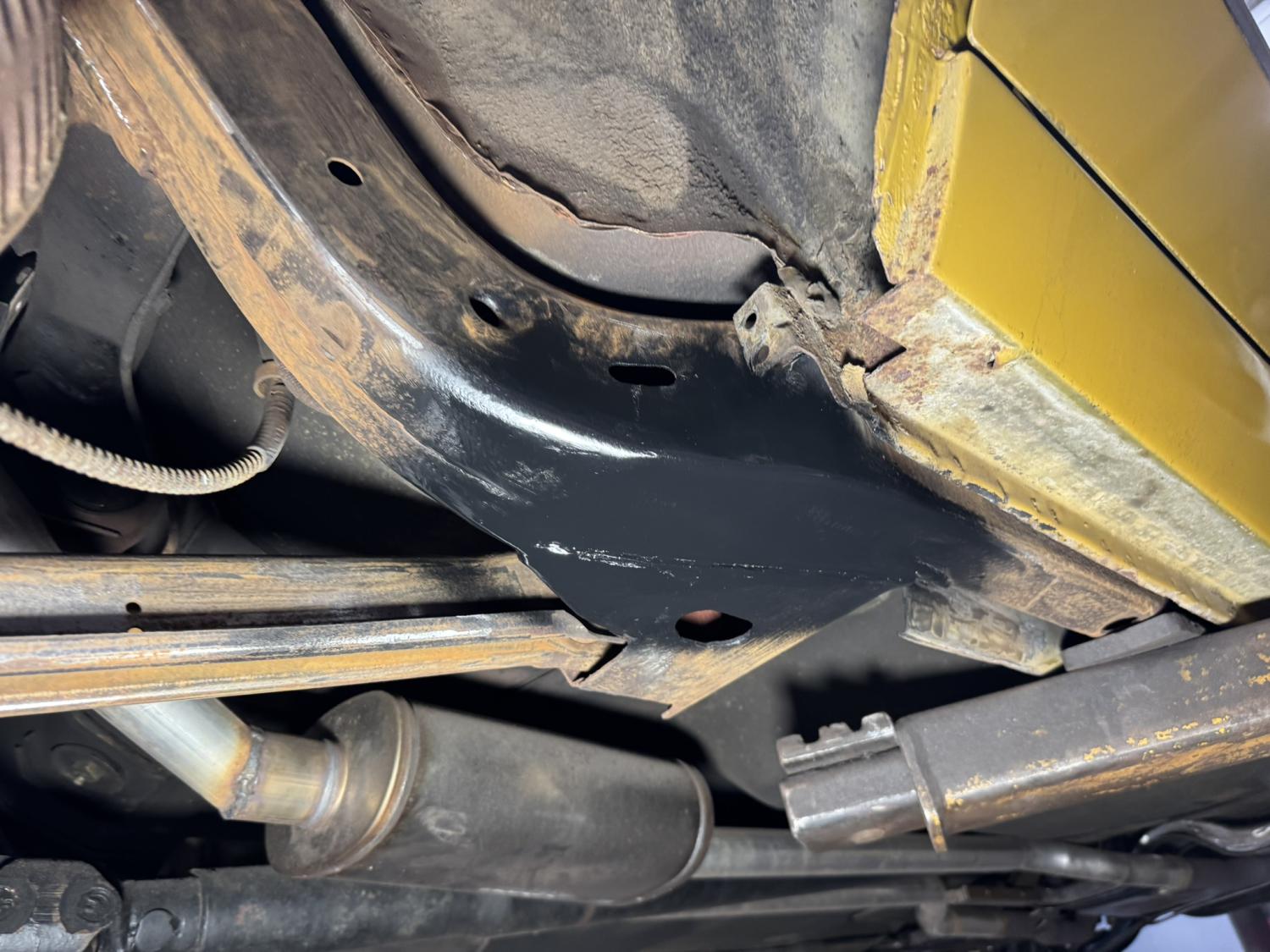

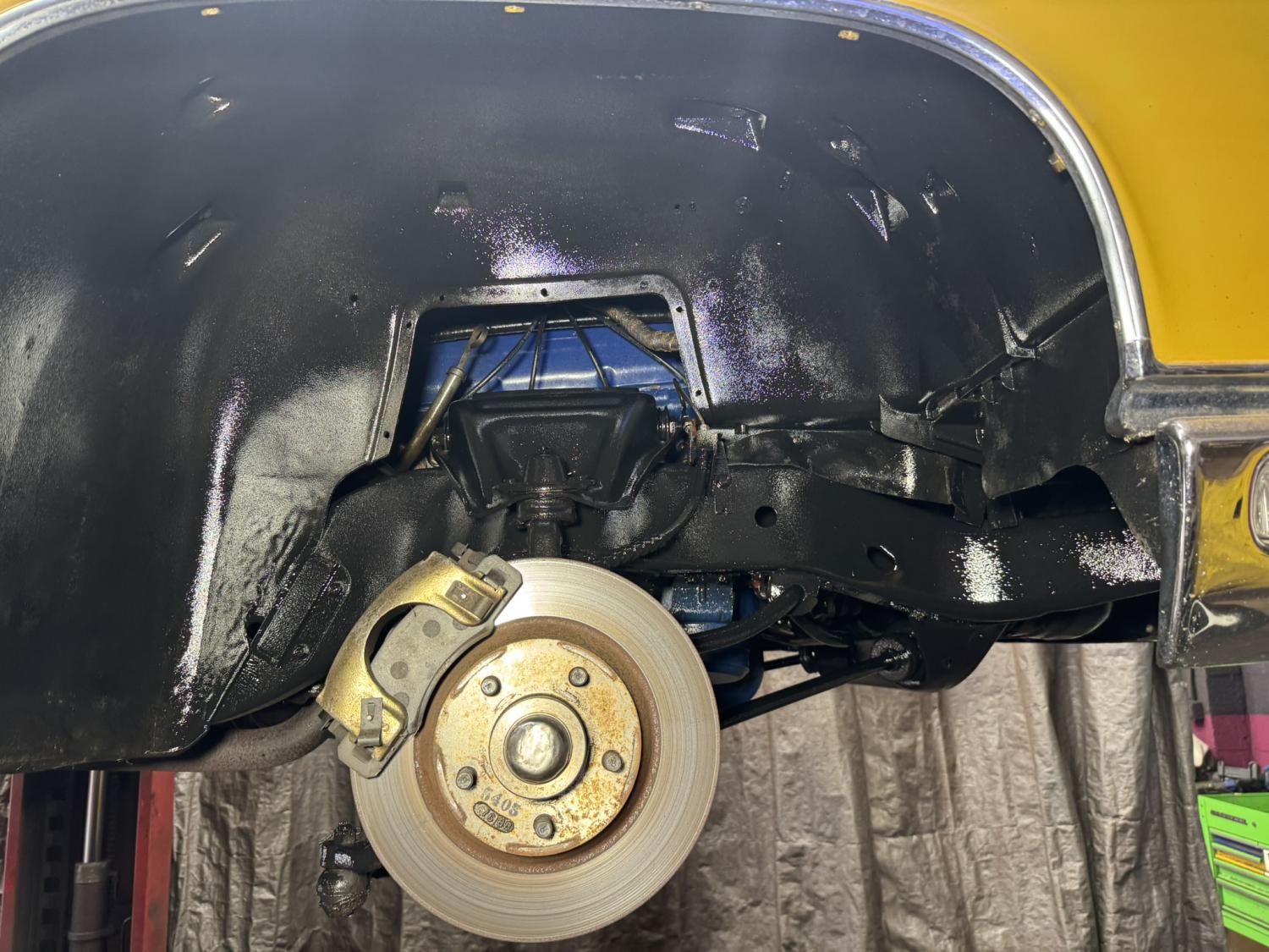

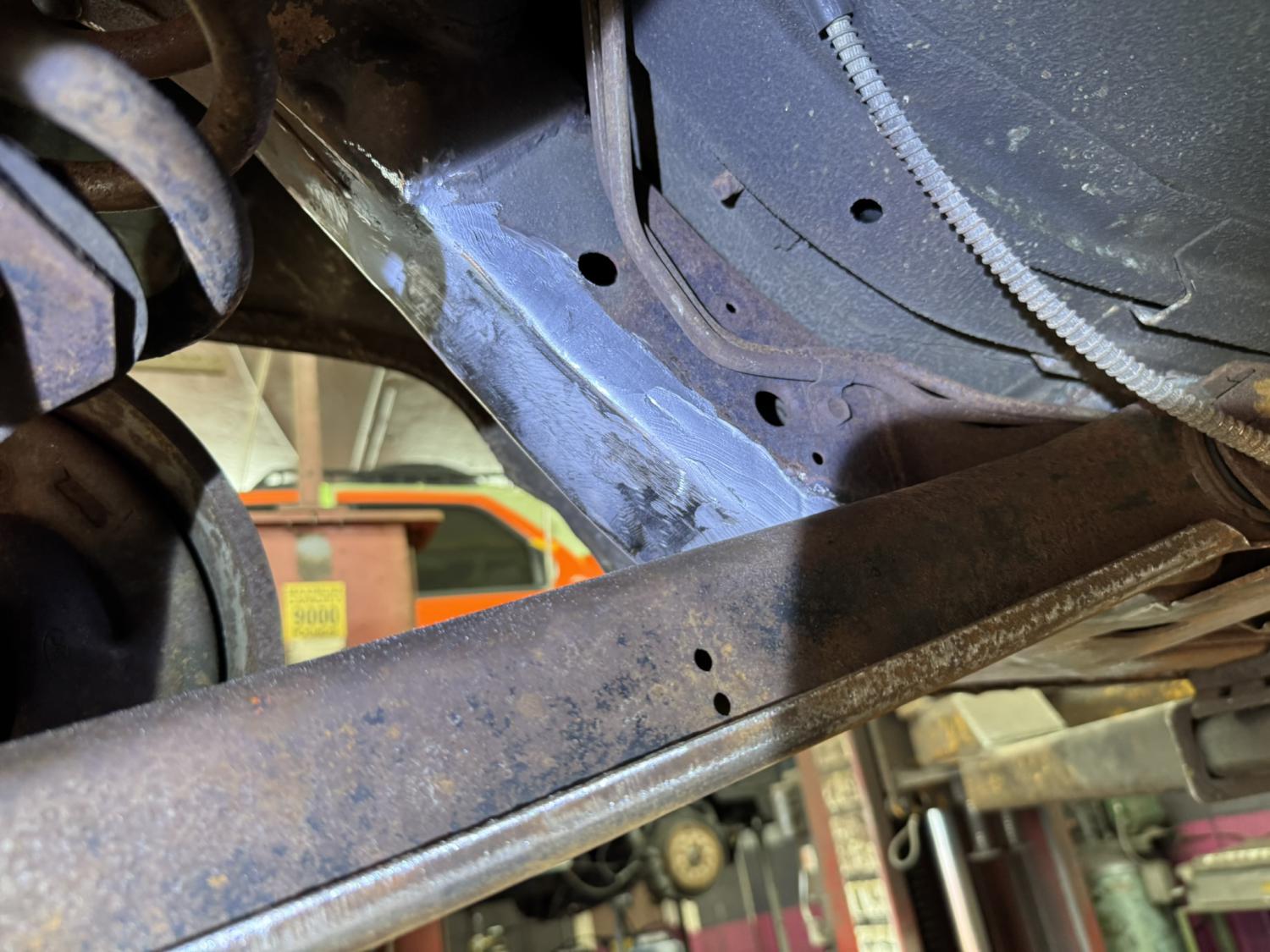

Passenger side:

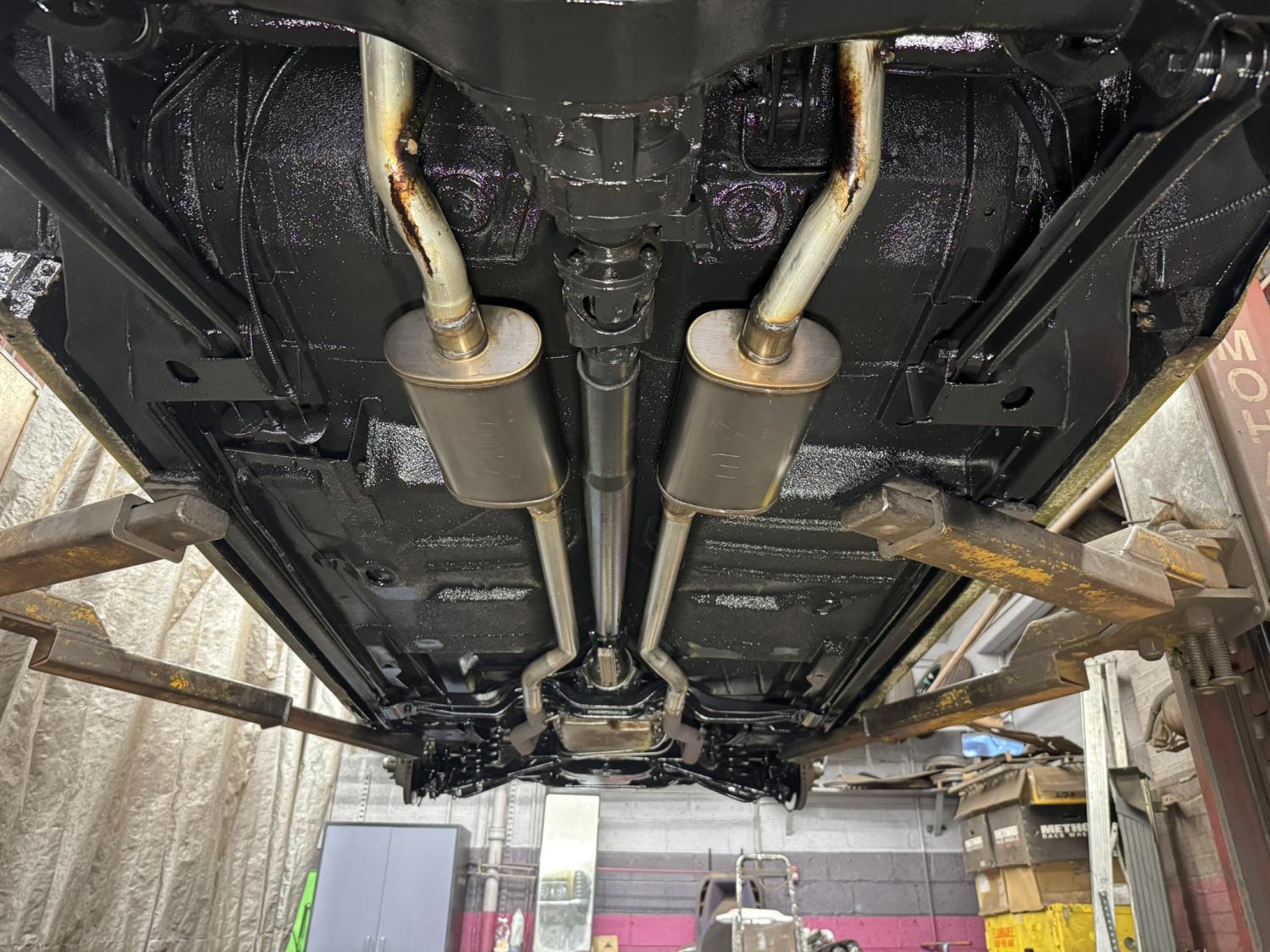

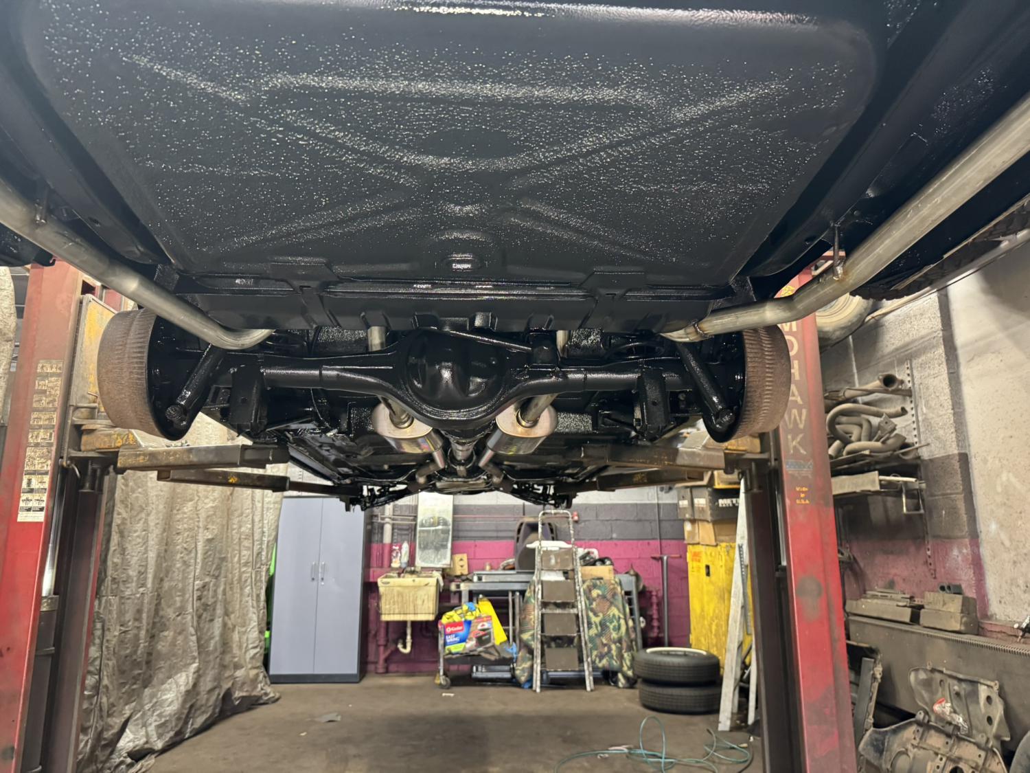

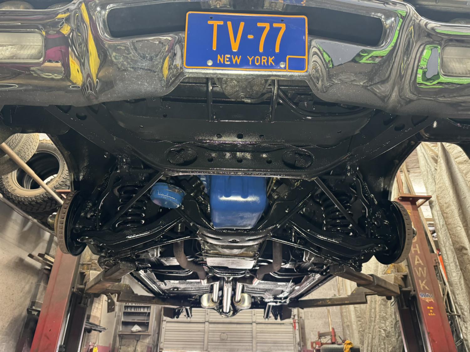

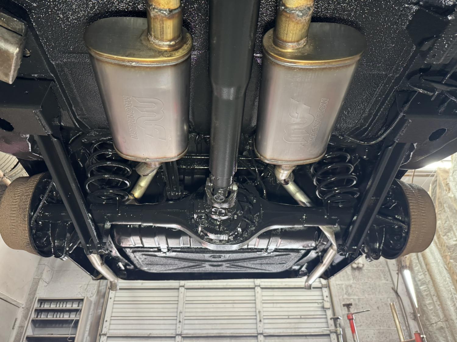

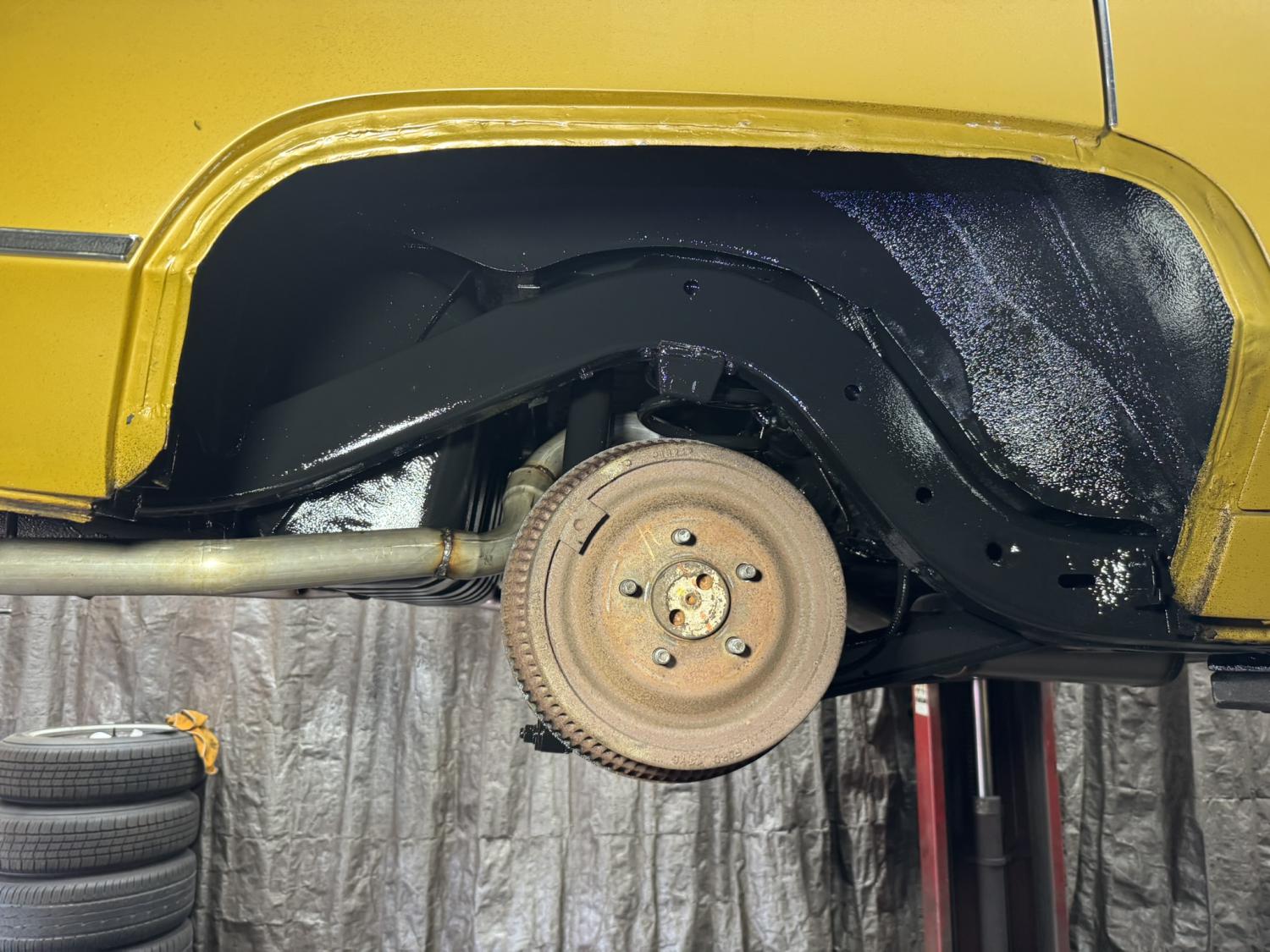

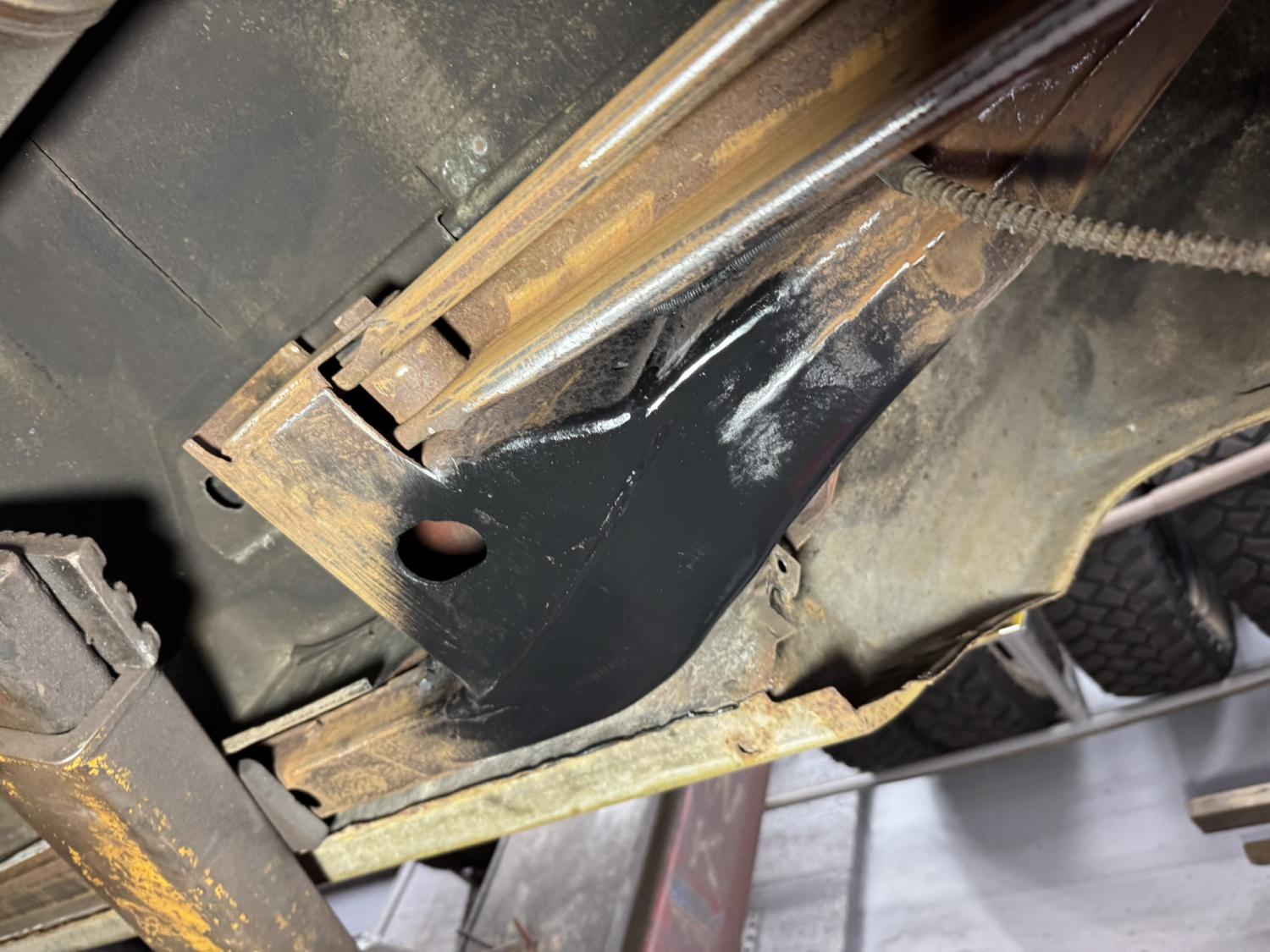

And after the pressure washing, wire brushing and cleaning, they applied the black wool wax. The stuff is a non-petroleum metal preservative. I think it is Lanolin based. They have clear and black. It lasts about two years and then needs to be reapplied. It's mostly for daily drivers in the rust belt areas, but it soaks into the metal and keeps it rust free. The only caveat is having to wear gloves if you are doing anything under the car. That, and waiting a few weeks for it to harden/soak into the underside original undercoating and metal.
BTW, these guys did the frame repair on my 1995 Suburban three years ago. The common rust area in the OBS 4WD truck frames are the sides of the front engine cradle near the steering box, that have no water drain holes. They did an amazing job on the truck so I had them schedule me for the Lincoln, too.
While the Lincoln was there they also had a Pontiac Aztek that they were repairing the unibody frame rails on...and at least a half dozen FJ Toyotas in the staging lanes for repairs. One of them was driven up from Florida for the work. Check out their facebook page and you can see the work they do. Amazing stuff!

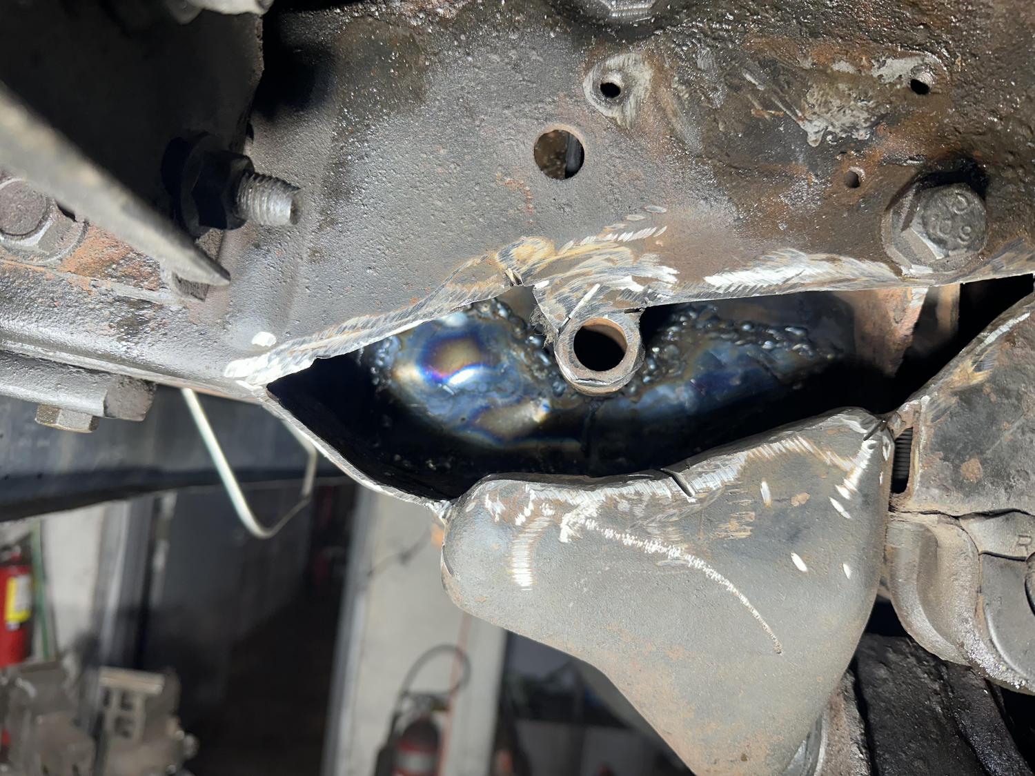

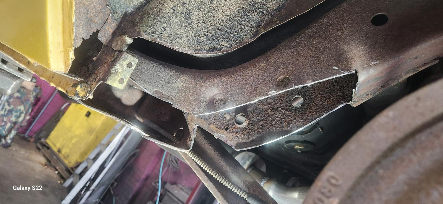

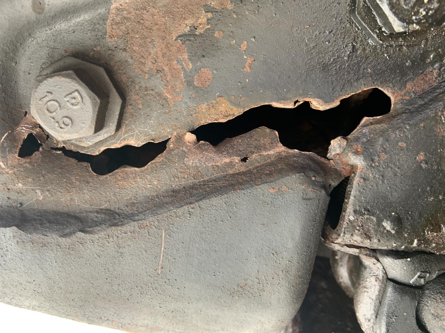

This was the front frame repair they did on my K2500 4X4 Suburban in 2023. Just as amazing! Both the inner and outer sections of the frame where the steering box mounts. A completely closed area with no drainage hole but open to water and salt getting in from above. The passenger side (the far easier side to repair) was repaired back in 2016 by another welder who has since retired. I can't say enough about this shop. It is worth the trip if you are looking for someone experienced and actually reasonable in their fabrication rates.

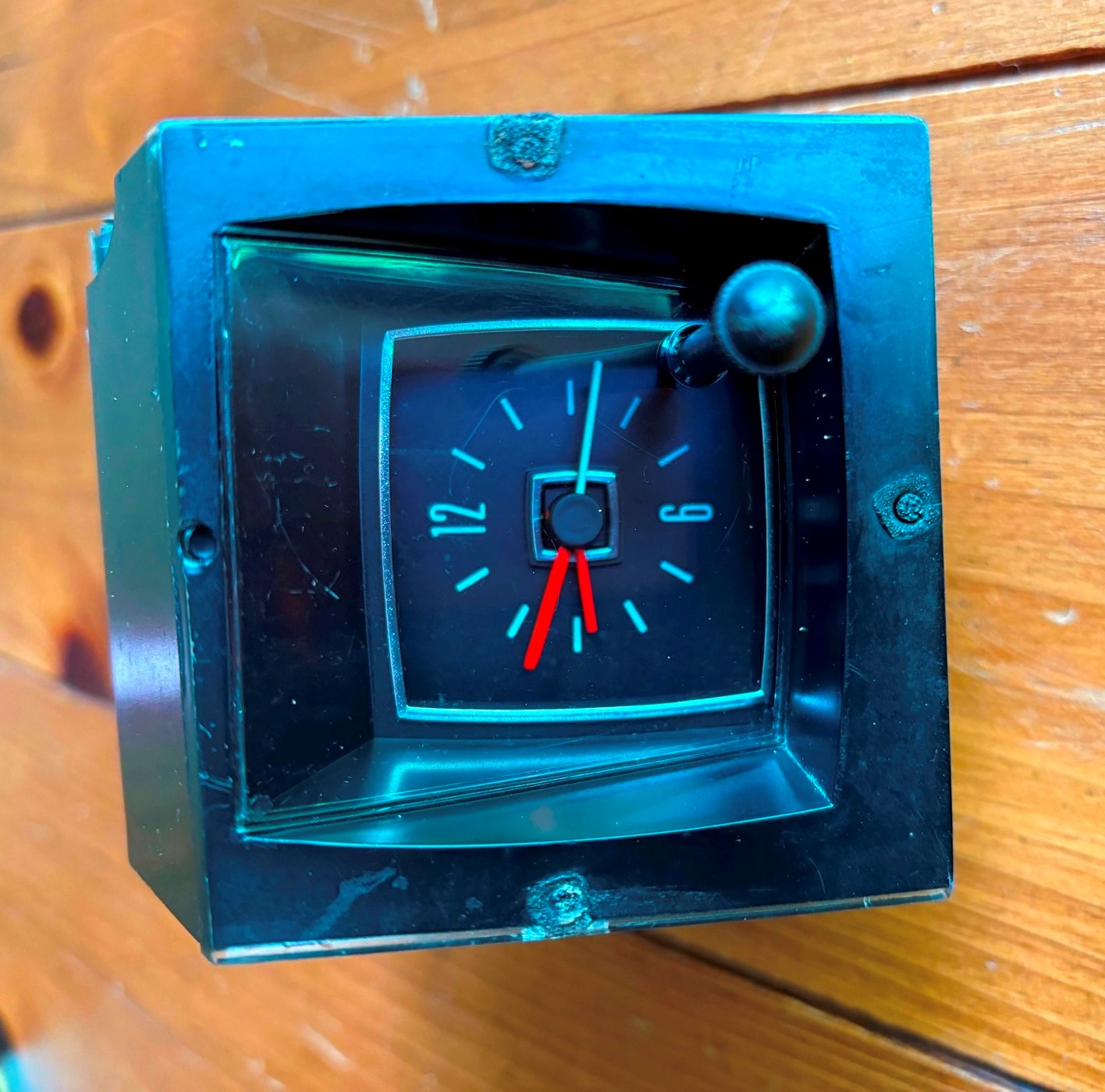

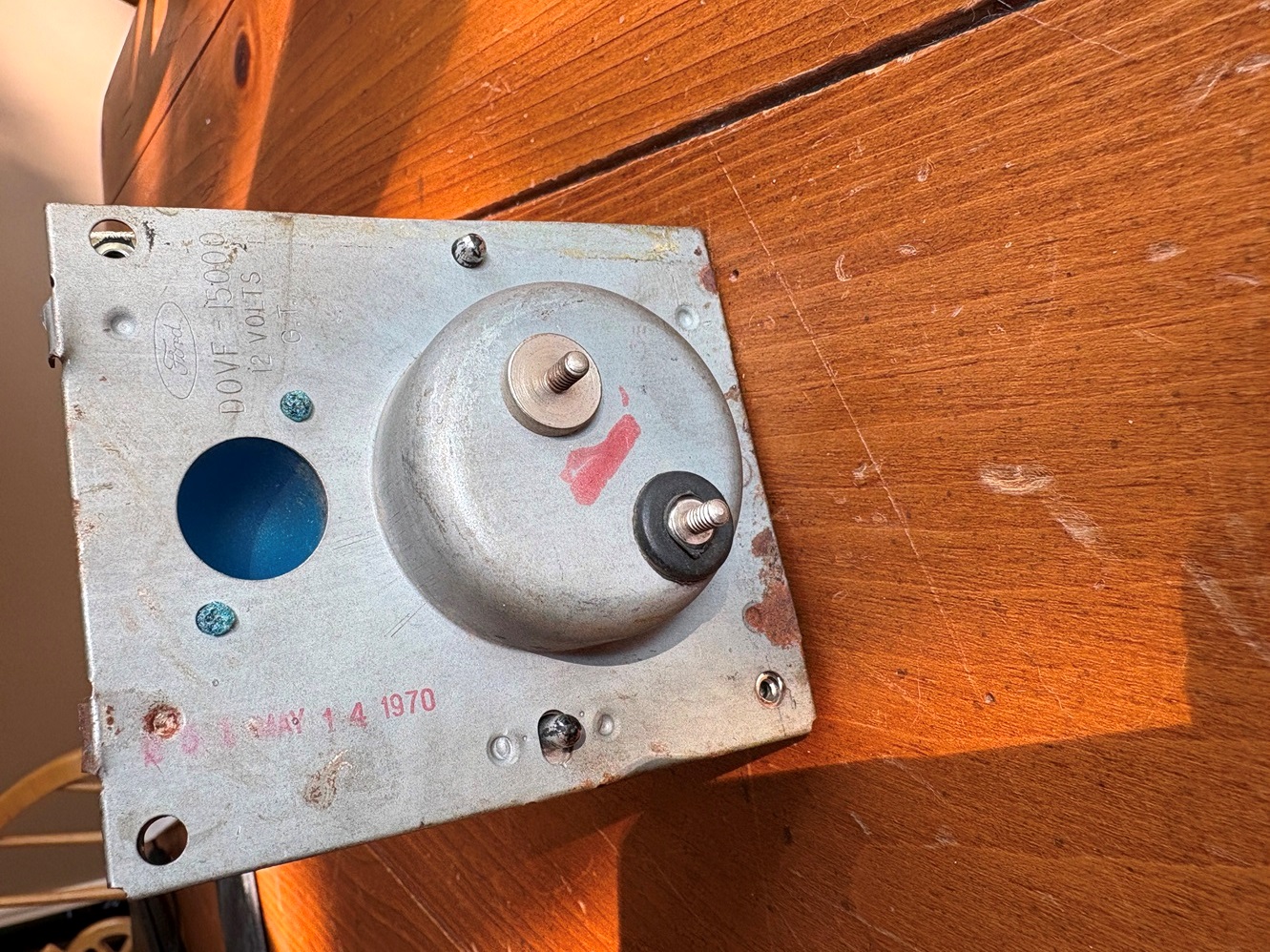

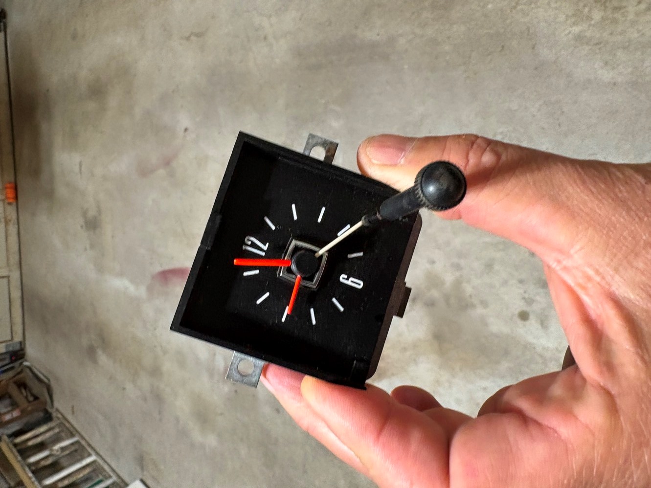

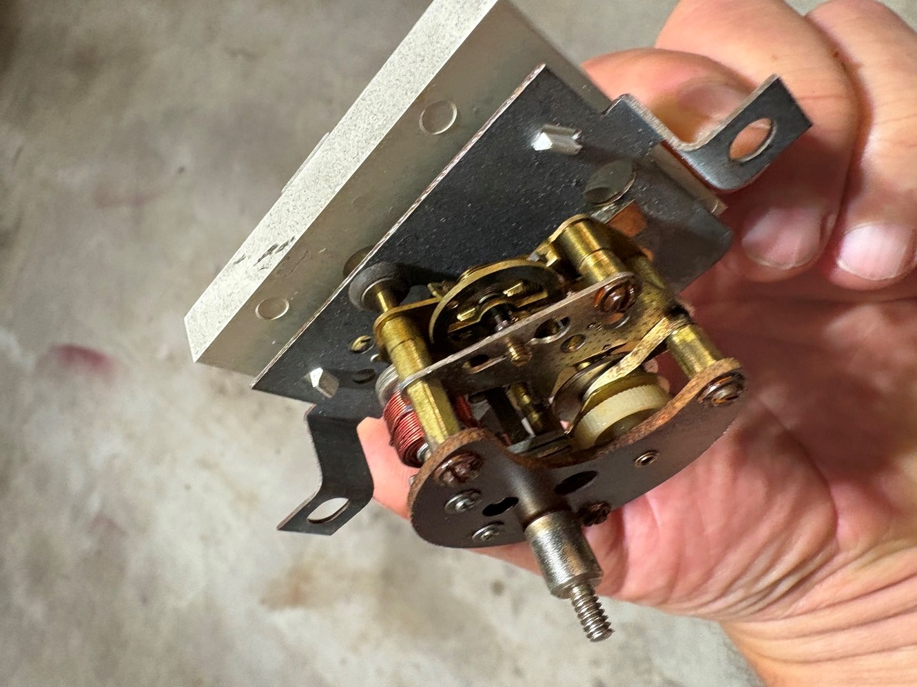

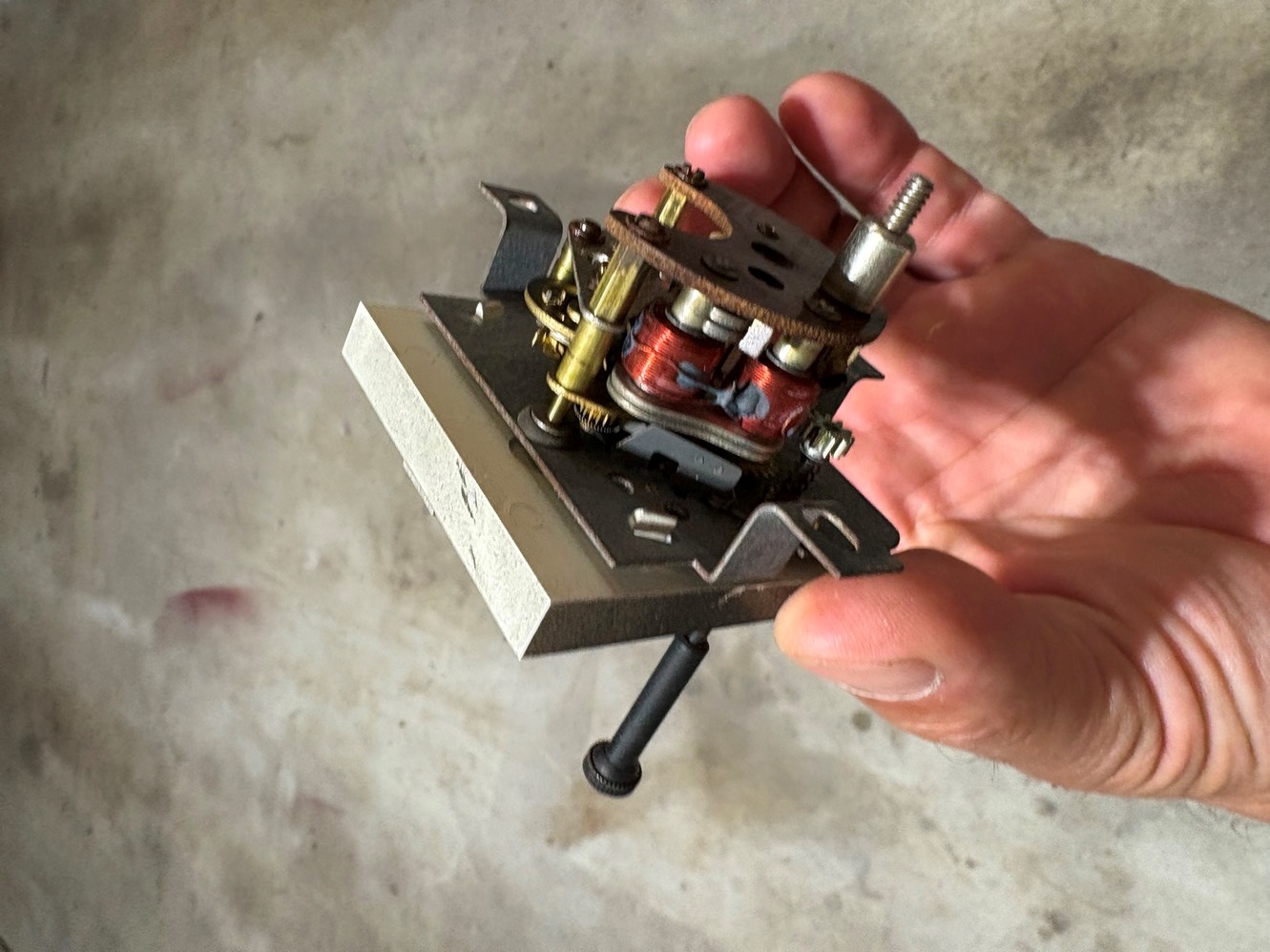

And I was playing with the spare clock I bought on ebay 4 years ago. I started looking on youtube for repair tips and it turns out the best tip is to use brake clean and spray away all the solidified factory oil on the pivot points. I did that and used my old points file and cleaned the two contact points. I then used a tiny needle applicator and applied gun oil to the pivot points very sparingly. I set it up on a battery and then set a stop watch. It runs beautifully. It was a consistent 55.7 seconds between the audible click when the points would contact and snap apart, thereby winding the mainspring for another minute. It got kind of addictive after a while: 55.79, 55.72, 55.75 seconds... for 25 minutes straight. It wound up being more of test of my thumb reaction time on the lap counter at that point. I left it overnight hooked to the battery and this morning it s right on time (actually a little under a 1 minute fast as compared to my Iphone). And the battery was still registering the same 12.7 volts as the day before, so there isn't much of a power drain after all with these factory electric clocks.
