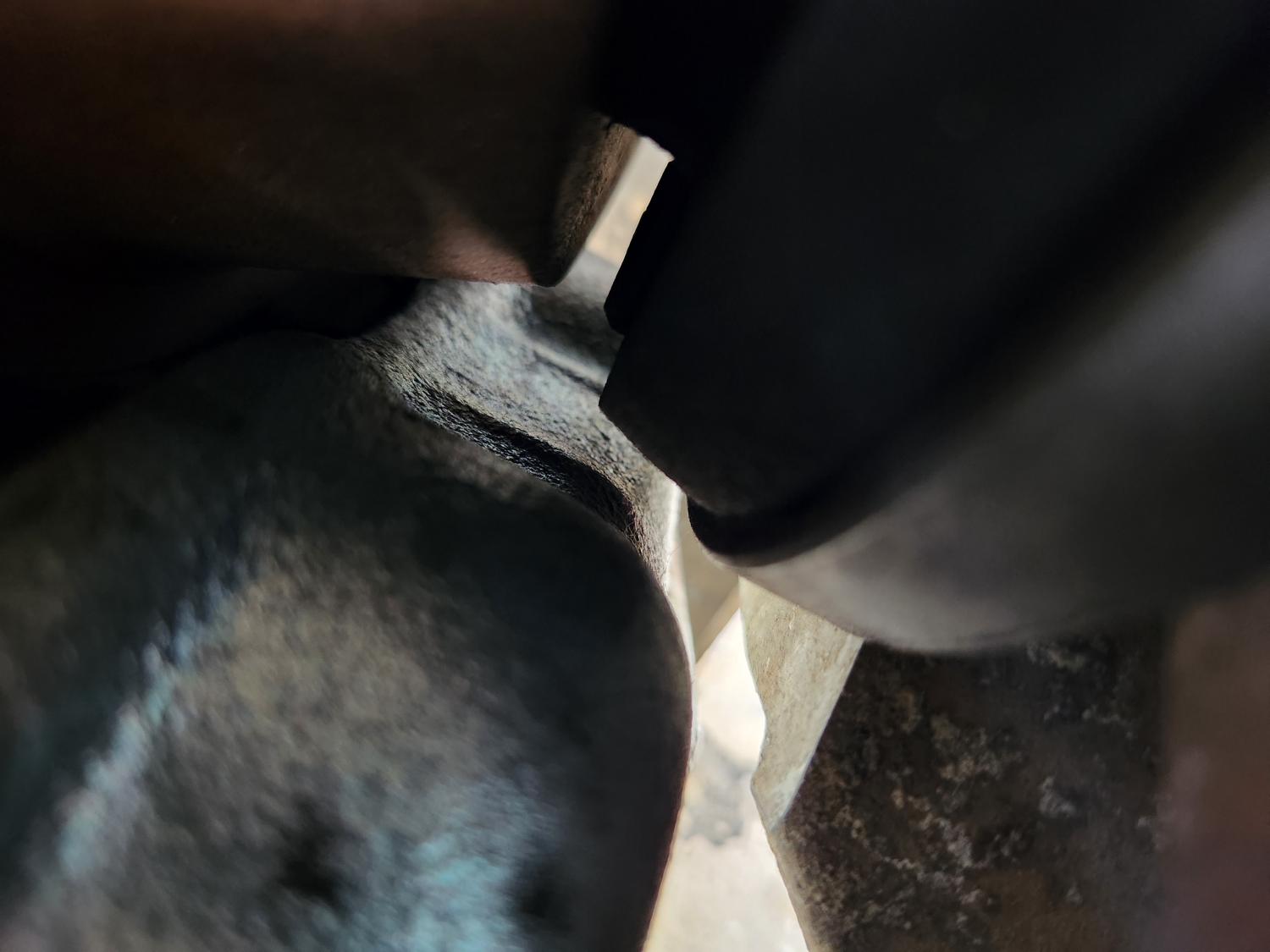

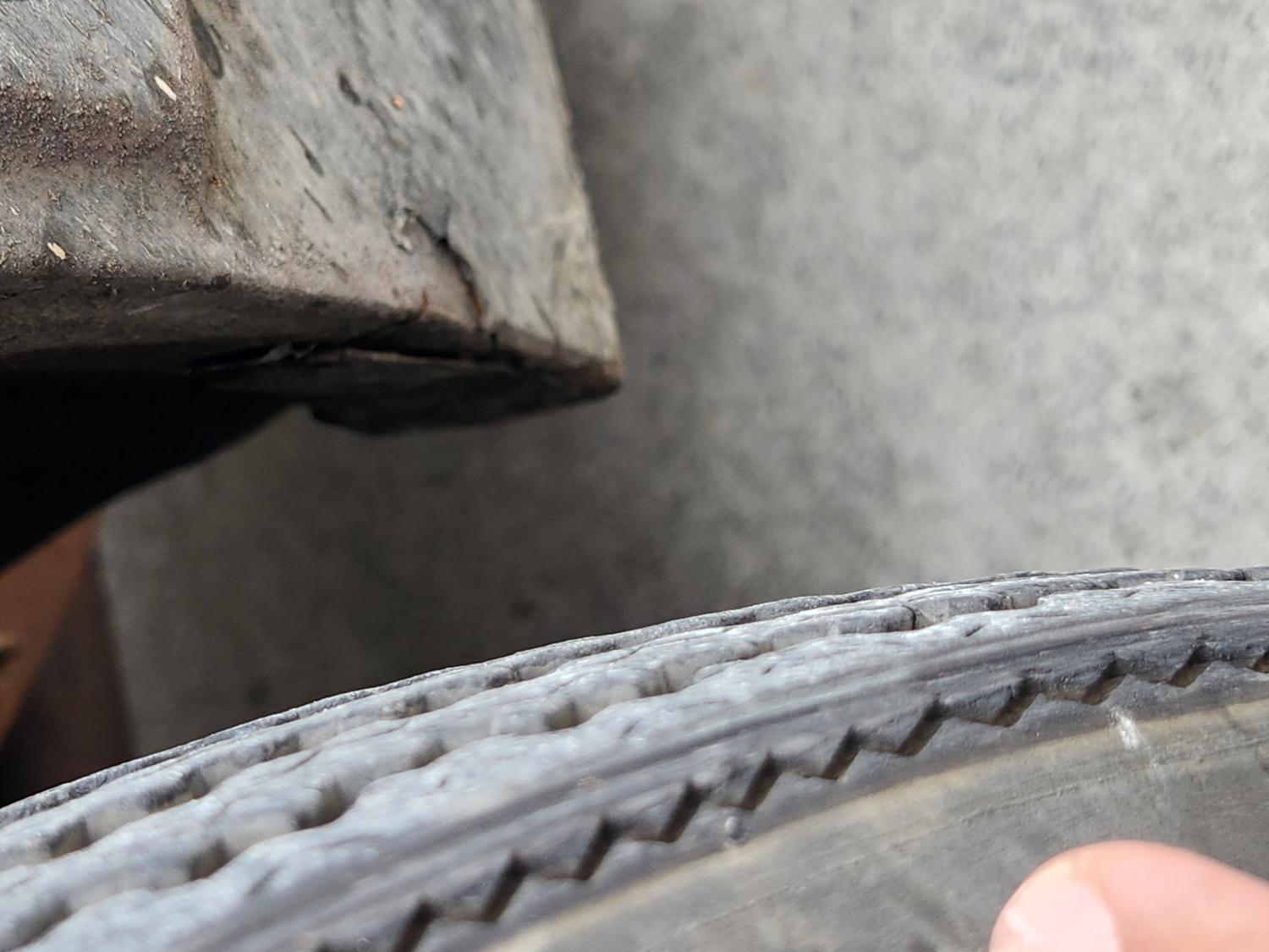

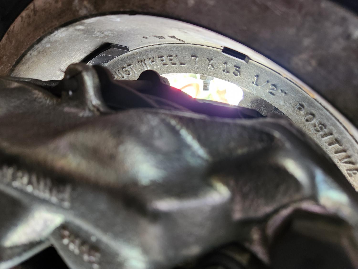

Nice! Whats the offset on those front wheels, and do the tires rub? Love the look.

Thank You! I really love the look too!
7x15" 1/2" Positive offset. I am re-using my cragar brand 3/8 spacers to clear the calipers but I bet 1/4" spacers would do it. The tires clear but on a sharp left turn, especially if the suspension is compressed, the left tire just barely rubs on a flaky rust area on the fender, I may just whack it in with a hammer just enough so it clears. The Torq Thrusts and these tires are night and day compared to the steel wheels I had on. I can feel the difference, especially from a stop. Maybe it is the tires? Anyway I'm really happy with the change.

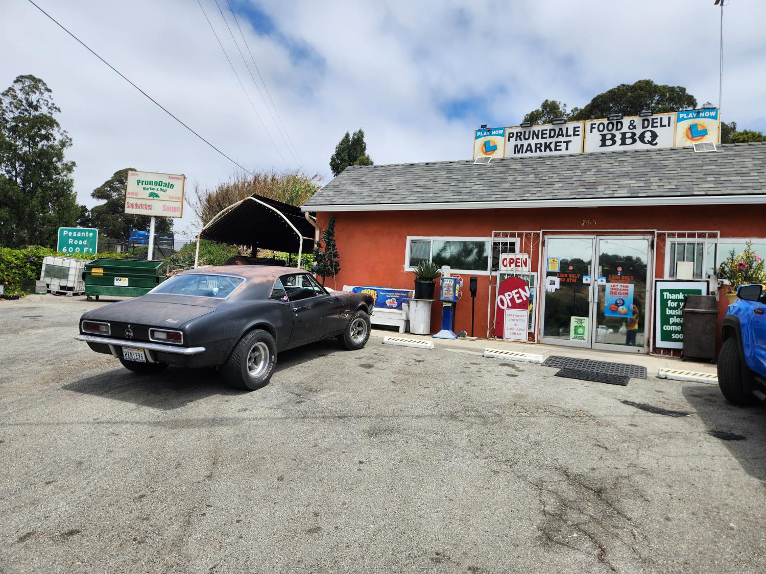

Here's a photo I took outside a little spot down the street where I usually order the soup of the day and Tri-tip sandwich.
